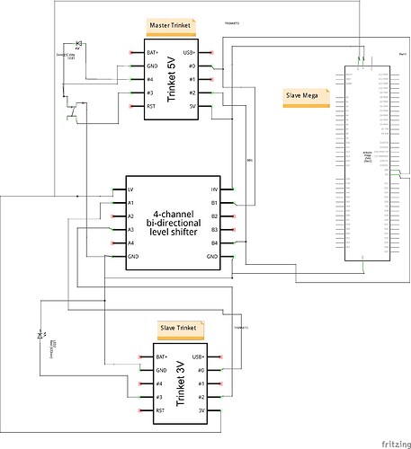

here is my dilemma...FIRST - what i am trying to do:
I have 2 trinkets and a mega 1280 (i know the schematic says 2560...but it doesn't have my model) talking via I2C...i have the master trinket 5V take input from a button...when pressed it is supposed light the LED connected to it and send a "1" to the 2 slaves...when you let go it sends a "0"...the slave trinket 3.3V waits for message...when receiving a 1 it turns on the led...a 0 turns is off...the mega does the opposite...0 turns it on the led and 1 turns it off.
what i have got working:
Trinket to Trinket I2C is working fine...where my issue comes into play is when i add in the mega...so i tried just trinket to mega...still a no go...so is there something i am doing wrong on the mega side??? the trinkets and the 4 bit level shifter are brand new from adafruit...the mega i have had for a while and have used to talk to other megas...i have attached code and schematic.

I didn't know WIRE and TinyWire protocols were compatible. I thought the ATtiny85 could not read WIRE and the Mega could not
read TinyWire. If they can I would like to know because then I can do the same thing with my UNO and my ATtiny85's .
from what i read...they are both I2C...and the TinyWire can read and write other I2C components...so i don't see why it wouldn't...but when i add the mega in the mix... i locks the trinkets...so i have no clue what is going on...i seen a vid of someone who is doing it here

Did you do the schematic ? If so , what software ?

Look at your schematic.
Level shifter LV input 3 not connected , HV 3 connected
LV input 4 connected HV 4 not connected
How does that work ?
Also, you don't show any current limiting resistors for the leds . Why ? (should be 220 ohms)
Why are there no 4.7k pullup resistors on SDA & SCL ? That's a standard requirement. I2C backpacks and lcds have them built in but when you DIY you have to include them to keep the bus stable and biased correctly.

I programmed the chips and wired up the circuit and it's not working . I can't even get the leds to toggle.
