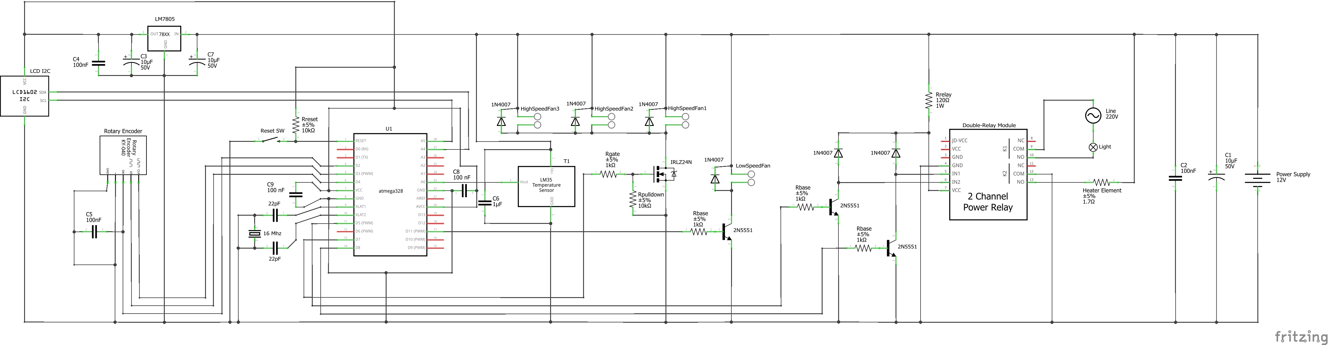

There's something that's bugging me and I think maybe it has something to do with this I2C problem.. I attached below the same schematic (now done properly) with the addition of the reset configuration for the IC. I set up a 10k resistor from pin 1 to VCC and a momentary pushbutton from pin 1 to GND. When checked for continuity with the multimeter the button's doing fine at closing pin 1 to GND, but when the IC's powered up I see absolutely no flicker on the LCD (or on the indicating LED of a relay I'm also using) when the button is pressed or even held down for some time. I thought maybe there is something wrong with the reset and might cause the IC to never fully initialize, I don't really know what to think anymore lol
Need to detail how the relay module comes into this and I think we need some pictures of this magic PCB.
Program a "blink" to operate the relay module.

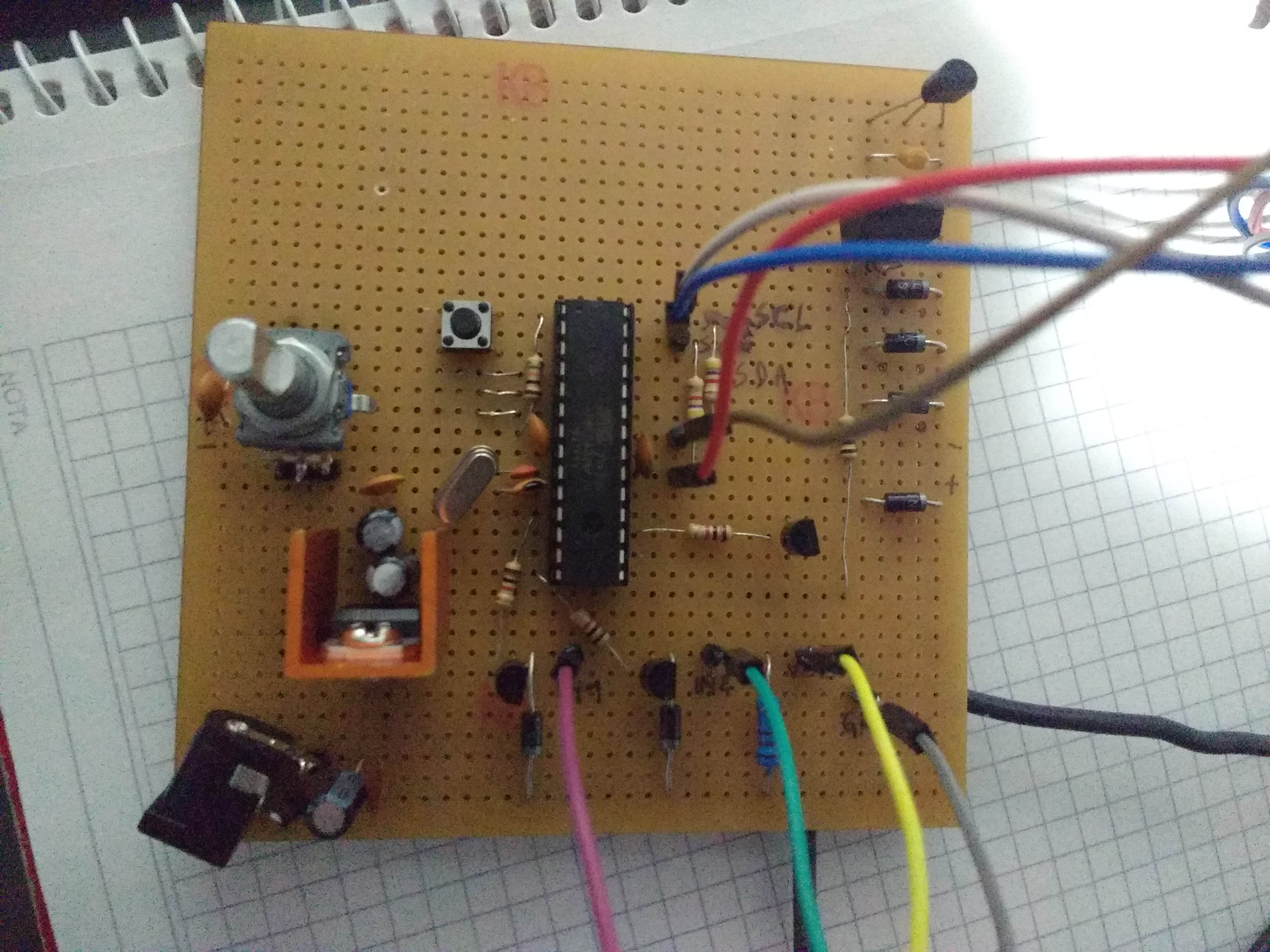

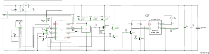

Ok here's the full schematic and pictures of the PCB!
I'm only begging in electronics as you might be able to tell by the schematic heh
So far everything worked as intended on the breadboard.
I'll get around the relay test tomorrow
