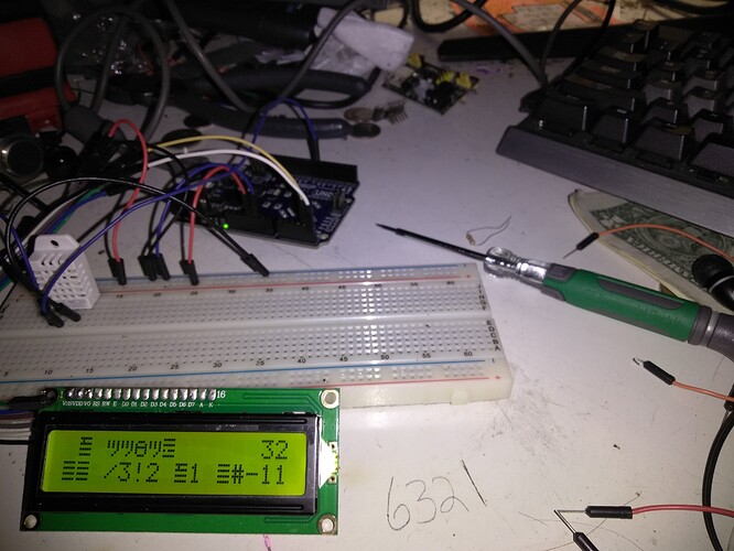

Hi guys I'm having a issue with my LCD screen and looking for help! I have a I2C screen that's is giving me bad charters. Now this was working at one point in time but after some time I started getting some bad screen charters. Now everything seems to be working in the serial monitor.
Serial Screenshot by Lightshot
Here is my code

Does a simple "Hello World" print to the LCD work ?
You should use pull up resistors and the longer your cable these should be smaller.

This exact setup was working! I'm not sure could I have shorted something out? Would not having a resistor cause this? Also the readings are working correctly in serial monitor Screenshot by Lightshot
Tyler5157:
yes,
Is this what u were referring to? Ive done that with no change to the screen.
From the picture, it appears to be a 2 line display of the 1602 sort. What are these lines from the code intended to do ?

Im not so sure why that's like that! I used a example hello world in liquidCrystal I2C
Making Progress.. I Think! I remove all lib's and used another "Hello World" These are my results!

Is this kinda what your talking about? When I said I might have damaged my board?
No, without pull ups you "damage" the squareness of the signal.
Check this explanation
Bad signal can cause incorrect reading of bits, especially a 0 for a 1
on the screen you have an S where a W should be.
looking at the bit patterns there is one bit not right (above the ^)
S = 0101 0011
W = 0101 0111
So indeed the screen read a 0 bit where the arduino sent a 1

After running I2CexpDiag these are my results.
Serial Initialized
I2CexpDiag - i2c LCD i/o expander backpack diagnostic tool
hd44780 lib version: 0.9.0
Reported Arduino Revision: 1.8.5
CPU ARCH: AVR - F_CPU: 16000000
 A4: digital pin: 18
 A5: digital pin: 19
SDA: digital pin: 18
SCL: digital pin: 19
Checking for required external I2C pull-up on SDA - YES
Checking for required external I2C pull-up on SCL - YES
Scanning i2c bus for devices..
 i2c device found at address 0x3F
Total I2C devices found: 1
Scanning i2c bus for all lcd displays
 LCD at address: 0x3F | config: P01245673H | R/W control: Yes
Total LCD devices found: 1

And after running hello world from you examples this is what came up. Thanks Again
No point in running HelloWorld when there are issues accessing the LCD RAM.
That type of issue could be caused by soldering issues.
When looking at your photos, I do see some soldering issues.
One the backpack side, there are two pins that look like they have poor soldering.
They are the 6th and 7th pins from the right in the photo.
That would be LCD pins 11 and 10 or DB4 and DB3.
DB3 isn't used, but DB4 is.
Those two pins need to be cleaned up perhaps simply reheating them would get the solder to flow better.
The strange part, at least for me, is the LCD side.
I don't see any pins sticking through the PCB. Normally when a header is soldered to the LCD PCB
a short amount of pin will stick through the PCB. I don't see this on your LCD.
Here is a photo of what I'm talking about:
It looks like the header pins on your backpack were not pushed into the LCD PCB far enough when soldered.
This may be causing connection issues.
