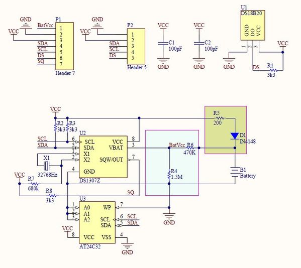

Here is the Tiny RTC :
First the Pull Up resistor is an simple Resistor or a specific resistor ?
Here is the 2 test i made.
The RTC module one the next picture is not the same i use. On the one i got there is 1 eeprom 24C32 witch use 0X50
So if i unplug the SDA SCL from OBD2 Module the RTC work Fine.
But i replug it only the OBD is reachable.

You need to have a 4K7 resistor between +5V and the I2C lines
Read the basics of I2C here - http://www.gammon.com.au/forum/?id=10896 - section - Pull-up resistors -

The resitor i tested was 4.7K I also test 10K

I make another Test ... and i saw the 0x68 is use by both module...
RTC on the RTC module
and MPU6050 for the OBD2 :s ...
