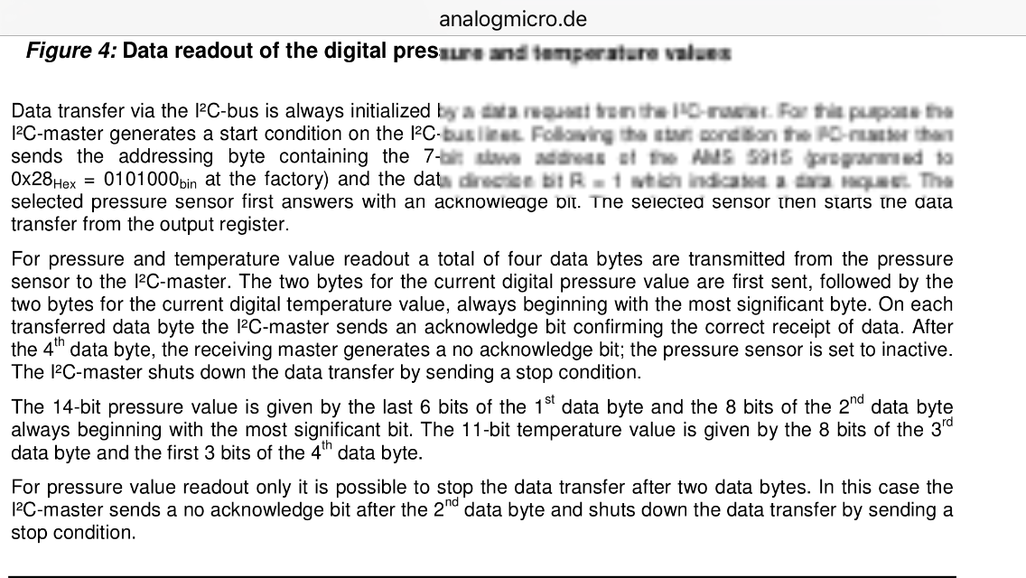

I'm trying to read sensor data with I2C, wire library. I'm having a hard time figuring out how to get out the actual counts for pressure and temperature. Probably very easy if you now a bit more than me. Could simebody please help me creating a sketch. Se enclosed image for sensor data... Thank you very much!!

The photo seems to be from page 8 here:

I think the address is 0x28.
Can you read the pressure and temperature ?
int n = Wire.requestFrom(0x28, 4);      // request 4 bytes.
if ( n == 4)          // check if 4 bytes are received
  int pressureMSB = Wire.read();
  int pressureLSB = Wire.read();
  int temperatureMSB = Wire.read();
  int temperatureLSB = Wire.read();
  unsigned int pressureBinary = word( pressureMSB, pressureLSB);
  unsigned int temperatureBinary = word( temperatureMSB, temperatureLSB);
  float pressure = (((float) pressureBinary - ? )/ ?) + ?;  // I don't understand which numbers should be used.
  float temperature = ((float) temperatureBinary * 200.0 / 2048.0 ) - 50.0;
An alternative could be:
  byte buf[4];
  Wire.readBytes( buf, 4);
  unsigned int pressureBinary = word( buf[0], buf[1]);
  unsigned int temperatureBinary = word( buf[2], buf[3]);
Thanks a lot, makes total sense... :slight_smile:
