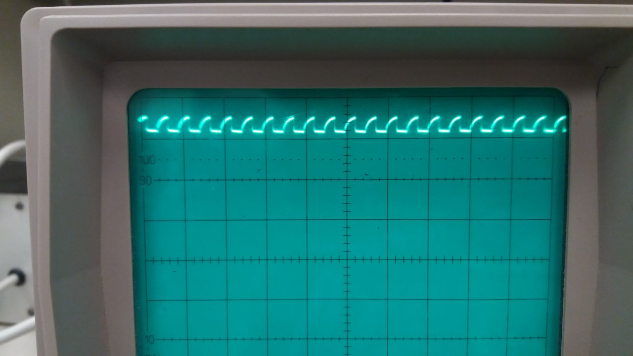

I tested the atmega board and it appears the level shifter is not working properly.
First of all, by setting A5, A4 (as OUTPUTS) to HIGH and LOW respectively, I get 3.28 and 2.88V on the 3.3V lines (shouldn't it be 3.3 and 0V ??).
Secondly, I connected the SCL and SDA 3.3V lines to a scope to see what the waveform is when the code hangs. Below is the scope output (same for SDA and SCL) with 20us/div and 1V/div.

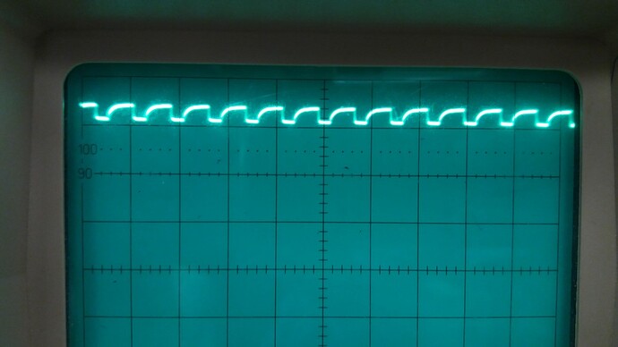

Lastly, I tested the level shifter with a 100Hz 0-5V square pulse from a function generator as input and expected a 0-3.3V square pulse as output on the 3.3V line. Below is 5V line input (for some reason not identical as the function generator output) with 20us/div and 2v/div.
And the - unexpected - 3.3V line output with 20us/div and 1V/div.
alex_poupakis:
Yes - they're not pulled down properly.

My circuit is the same as sparkfun's. In mine, i simply offer more pullup resistor value choices with the pcb jumpers. But, currently, the 10K pullups are soldered to +5V and +3.3V, so both circuits are the same.

I think you should forget 10 K resistors, and use 5K. This isn't causing your voltage problem on the Low side, but it appears to me your scope is showing way too much latency on the rise time. Way too much. This is probably going to affect timing, and 5K will allow a faster rise time. The datasheet shows 10K on the Si7017 typical application, but 5K should be ok.
Third thing is you have to isolate your low voltage problem. One strategy for doing that would be to disconnect the TMP112 and Si7021 devices, but leave your pullup resistors in place. then, put a scope on your clock and data lines, and have the Uno scan the bus. You might see the expected voltages. If not, you might make sure you are using the scope right, e.g., are you using 10x probes with the the corresponding setting on your scope?
if you get the correct voltage in the configuration with only an Uno, add things in one at a time until you see which one is providing the DC offset.
