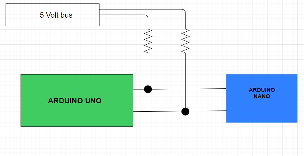

I am learning about the I2C protocol right now. A while ago, I watched a video where the dude said that the SCL and SDA lines going from the Master to the Slave need to have some sort of "Termination resistors".
I cant find the video and need some advice on what these Termination resistors are and if I really need them for every I2C project I run.
  1. I had success communicating between a UNO and a NANO using the I2C protocol without using the termination resistors. Did I just get lucky? The slave did what it was supposed to do as intended.
  2. Is the general resistor setup in the pic below good enough to satisfy the I2C termination resistor requirment?
  3. What value resistors need to be used , if they are needed?
The pic of my intended setup with the Termination resistors is below.
Thank you all for your replies!

Most Arduinos have pullups on board. Many modules also have pullups which may have to be cut off for not overloading the bus.
Ty for the reply. So I am assuming that when I have a project where I am using just the ATMega chip, then I need to build my own Termination ressitor setup, correct?
Correct.
They are called pull up resistors, termination resistors are something else.
Pull up resistors hold SCA and SCL high, the chips then pull them low as needed to send the data.

Internal pull up of the SDA and SCL pins is enabled with the wire.begin() command.
The internal pull up is weak, but ok for short I2C wiring.
Boards like the Uno/Nano only rely on internal pull up, but the Mega has physical 10k resistors.

I've lost track of all the replies but try without, if they are already built in to one of the devices then it will probably work ok. If it doesn't work add the resistors, for most purposes anything between about 1k Ohms and 4k Ohms for each resistor should be okay.
3.3K to 4.7K for 5V systems.
2.2K to 3.3K for 3.3V systems.

If the Uno and Nano are right next to each other, then you don't need any pull up resistors.
The internal pin pull up on both, that's enabled with wire.begin(), should be enough.
If the processors are further apart, then external pull up (resistors) are required.
The value depends on distance, type of wire, and I2C protocol (100kHz or FastMode+ 400kHz).
