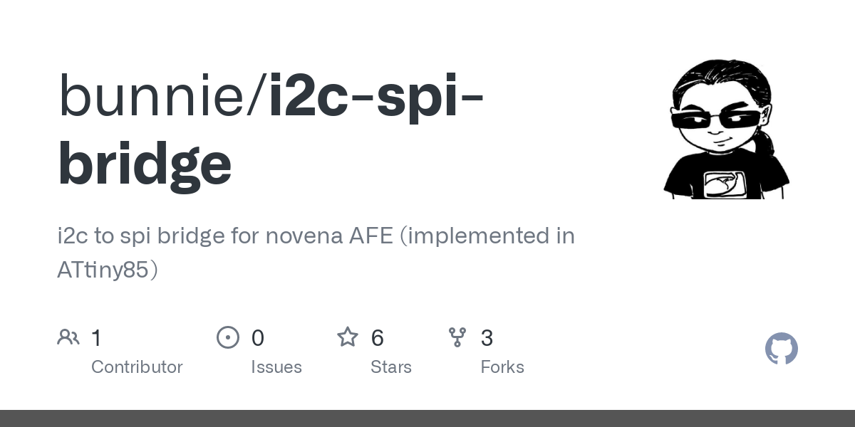

I have found this https://github.com/bunnie/i2c-spi-bridge
which uses an ATTiny85. If this could also work with a 13 could someone tell me how to connect it? I have never worked with it and can´t make heads or tails from the example code.

The ATtiny13 has no I2C bus. The ATtiny85 has flexible universal hardware that does it all, it is called the USI (Universal Serial Interface). That makes a big difference.
You can use the ATtiny13 for a single task, or maybe two or three very simple tasks. Driving a fan with a pwm signal, reading an analog sensor, and so on.
