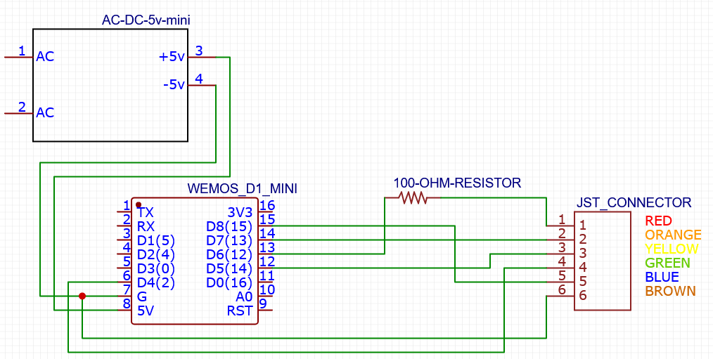

Let me start off by saying I am pretty new to this.
Some important information:
  • ESP8266
  • Injecting myself between the main board of the ice machine and the control board (led lights, power on/off, etc)
  • 6 wires between those 2 boards.
I followed this guide: Smart Ice Maker
Note: I don't have the same ice machine but it seems to be pretty much the same thing.
My issue:
It seems that when connecting the red wire directly to ground for a second or so, the machine turns on, or turns off.
I cannot seem to be able to figure out how to approach this using an ESP8266 in order to be able to send it signals (basically put that wire to ground). Currently using the same as in the article, Wemos D1 Mini and have the wire as an output pin. The code seems to send LOW signal then high.
Seems to not work at all. I am unsure what to do in order to be about to control it .
The schematic:
Any ideas?
Thanks

Draw diagram showing you between two things, There shoukd be three things, with you in between.
Do you mean to say the red wire, when grounded, turns the machine off if it was on, and vice versa?

Correct, the red wire when touching ground turns on the machine and vice versa.

What is the voltage between the brown and other wires?

Code posted is original. I only changed values (users, pass, mqtt stuff). I did change that if statement to make it easier to troubleshoot while sending ON / OFF via mqtt, which I can see in the serial monitor, getting those values just fine.
@JCA34F, Between brown and red = 5v (brown is ground). The rest are ~ 1.5 volt with machine "off" but w/ power.
OK, just peeping into the code, I see exactly what I expected
  if ((!strncmp((char*)payload, "ON", length) && state == "Off") || (!strncmp((char*)payload, "OFF", length) && state != "Off")) {
    digitalWrite(button, LOW);
    delay(200);
    digitalWrite(button, HIGH);
A brief LOW going pulse delivered to pin 13, and therefor to the red wire.
Since manually connecting the red wire to ground turns the device on and off, we would expect the pin 13 output to do the same, that is what the original depends on and exploits.
Maybe you could measure the voltage between the red wire and ground, with the red wire hooked up as the original has it, and see if the voltage goes to zero for the pulse when the code turns the drive on and off.
Also, put a print statement right on in there to be sure the flow of the program is correct and it is actually trying, and lengthen the time the "button" is "pressed", viz:
Serial.println("                   toggling power");
if 200 milliseconds didn't break anything, 1000 probably won't either. You could bump it up 200 milliseconds at a time from 200 and take the measurement and observe the behaviour if you wanna be conservative. Several experiments.
If that does not work, and it is being execute, you will have to fall back to using a relay module to stand in parallel with the existing button.
But TBH it makes me worry that there are other differences...
You could test further by watching for the print message I suggest adding, leaving the red wire disconnected and acting yourself on behalf of commands printed by the code to press the button when it tells you it is doing. Just give the real button a good press when it says.
Or just leave the read wire unconnected and the device on - the code neither knows or cares if the device is on, off or being switched.

Increased delay to no avail, but here are some findings:
Red wire to ground = 5v
Pin 13 (where red is) to ground only ~3.2v. I saw online maybe the ESP8266 can only output 3v. Can be powered by 5v but that's it. Thoughts?
I do see the pulse going near 0 when sending the ON / OFF command.
Didn't notice you were on a 3.3 volt board, so maybe when connected the pin never seems HIGH to the device.
But isn't that the board the original used? I'm out of an idea and can only offer the relay advice and without combing through the software say that if that button doesn't work, neither might any of the other signals the Arduino board generates.
There are solutions less clunky than relays.
Didja try being the power switch master to see if the rest of the signals do plausible things when injected as they are by the Arduino board?
