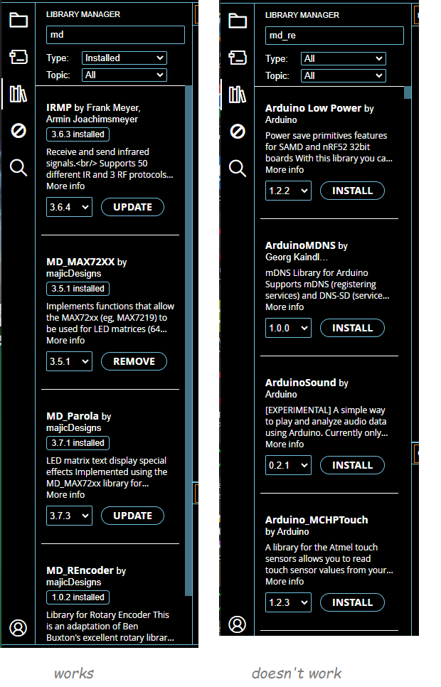

I'm still having a small issue here.&nbsp; The left snip is from a program I'm editing and the library manager search window shows a partial search term.&nbsp; This instance of the library manager works, that is changing the search term alters the results shown.
The snip on the right is from a sketch which is also capable of being edited.&nbsp; In fact, it's one mentioned above that I couldn't close during the IDE glitch mode. &nbsp; As can be seen the library search function for this sketch does not respond to the search term. I can scroll the results window up and down as per normal.&nbsp; For giggles I opened a third sketch and it behaves like the right snip.
I've closed and reopened this sketch a couple of times with no change.
Is the library manager capable of responding to only one sketch at a time?

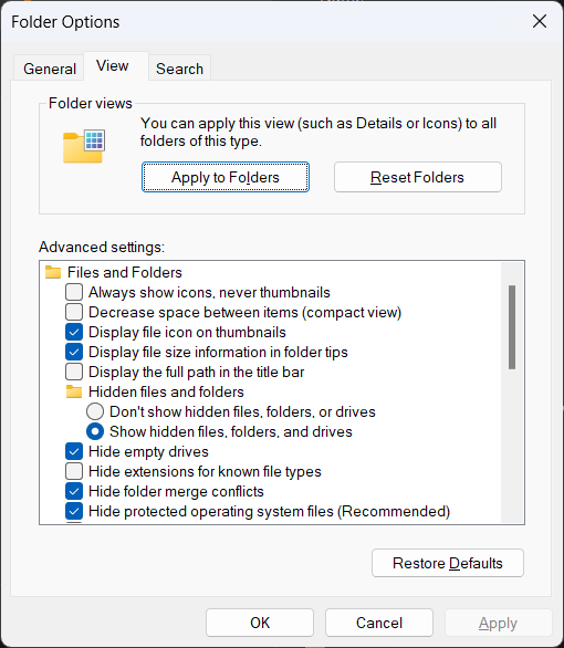

AppData is a hidden directory. You can enable "Show hidden files, folders and drives" under the options in Windows explorer.
 ![image](https://europe1.discourse-cdn.com/arduino/original/4X/f/b/d/fbd4774e02bd11f357321b0e85cfd3dcf7e736ff.png)

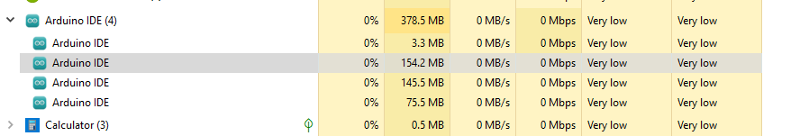

Additional info - snip from task manager. Hoping someone who knows what it means will find it useful:
 ![image](https://europe1.discourse-cdn.com/arduino/original/4X/b/9/7/b973bf3b486c81196f56cea90f20b04a7d2563d9.png)
Task manager shows four instances of IDE. In reality only three instances are running and I cannot close any of them using the windows close box. There were several other instances which I was able to close. Before closing the others down I went through and shut off the serial monitor wherever it was active. This had no effect on 'closeability'.
