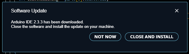

This happened once before and I blew it off.
Win10 system installed 2.3.3 and loading/saving/editing sketches.
Shut PC down, to blow dust out, and on reboot IDE reverts to 2.0.2. Also on screen is 'new version available...' popup.
 ![image](https://europe1.discourse-cdn.com/arduino/original/4X/0/6/5/065af3e37d8f86e5c672bdcd2a7e441deb281b92.png)
Selecting 'download' yields:
 ![image](https://europe1.discourse-cdn.com/arduino/original/4X/8/7/1/871b759353edb00aff8b7201dd1d0ec48af7143b.png)
Which brings us to:
 ![image](https://europe1.discourse-cdn.com/arduino/original/4X/5/3/8/538eb15118fe225052b7c75349d041e365c3e7cb.png)
Clicking 'finish', with box checked restarts IDE and all is as it was.

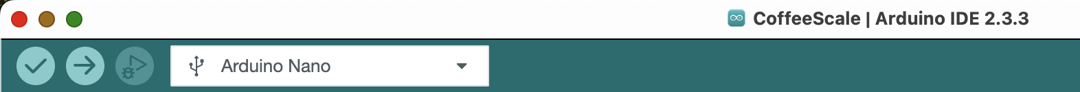

Start the IDE and do a screen grab like mine.
 ![Screenshot 2024-10-29 at 13.38.26](https://europe1.discourse-cdn.com/arduino/original/4X/e/d/7/ed7548ac7fbf3292a7680f91120bb2b5f750e12d.png)

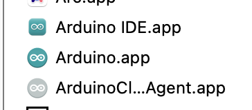

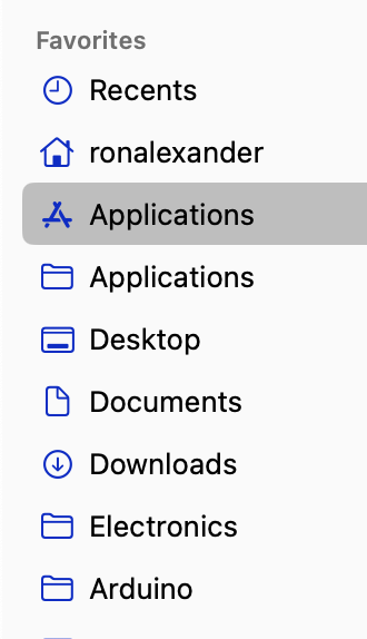

Very weird. I would look at the applications folder and see how many copies of the 'Arduino IDE.app' there is, then do a GetInfo. Long shot, reboot in case there is an instance of the app running somewhere.
 ![Screenshot 2024-10-29 at 14.22.20](https://europe1.discourse-cdn.com/arduino/original/4X/a/1/e/a1ed3fe84429ea89ff00f7e1be5bfabcb9947cd3.png)
 ![Screenshot 2024-10-29 at 14.23.26](https://europe1.discourse-cdn.com/arduino/original/4X/c/a/e/cae1587a47aa510d3ff981326de4b70aa1934414.png)

Based on [this thread](https://forum.arduino.cc/t/ide-2-2-3-only-opens-last-sketch/1311228) I deleted a number of log files. This may have started then but I can't say for sure.
> [@sonofcy](#):
MIght the 'applications folder' go by a different name on my machine? I'm not really conversant with the files in the 3-OS (C:) directory, as its named on my drive.

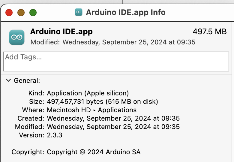

Wow, you need to understand that and a ton more before ever thinking of doing programming. I don't know how to answer, it's basic knowledge. Here is what my finder screen looks like but I probably modified it.
 ![Screenshot 2024-10-29 at 15.45.28](https://europe1.discourse-cdn.com/arduino/original/4X/f/2/e/f2ef78da759c744db6db863416995882d3a6de99.png)
Here is another view. Start at the system drive for you may be that 3-OS(C:) directory
