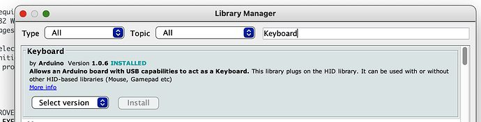

Check the IDE2 Library Manager like this
Do you see 1.0.6 installed?
Now I did a search for Keyboard in IDE1.x Library Manager and see identical.
That is how it's supposed to work.
