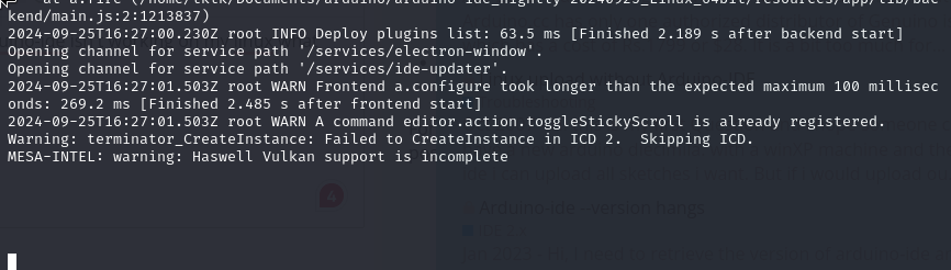

i come back home after a while and the arduino-ide isn't working on my linux what could be the problem

There is no obvious error in your output. Please post the complete output (using code tags as described in How to get the best out of this forum).

it was previously working, rebooting doesnt work, and yes I did get it from the site, there is a warning about Haswell Vulkan support is incomplete tho need more insite on the warning message
downloaded and tried the app image still nah
ICD is the acronym for "installable client driver". This seems to be mostly often related to the GPU (i.e., the graphics card on your computer).
I haven't seen previous reports of this specific symptom, but when other users have had problems related to the graphics card, the workaround has been to add the --disable-gpu
to the Arduino IDE command line invocation.
Give that a try and let us know whether it fixes the problem.
