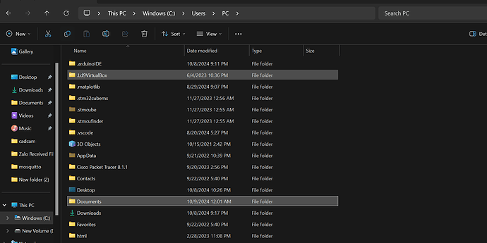

I haved a "Documents" folder in C:\User\Pc
but arduino ide still not open
ohh it's opening. Thanks!!
