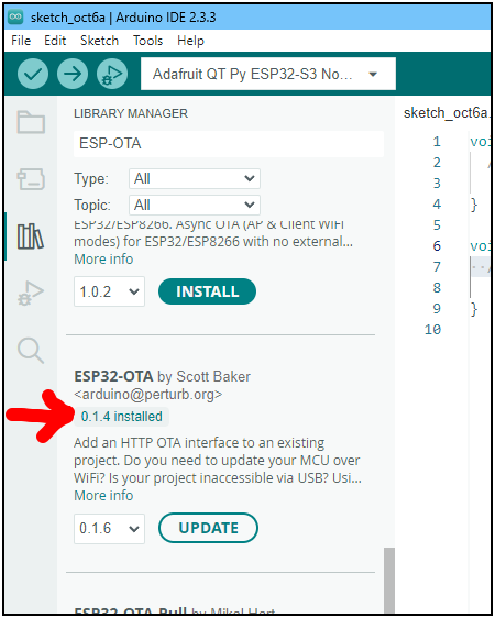

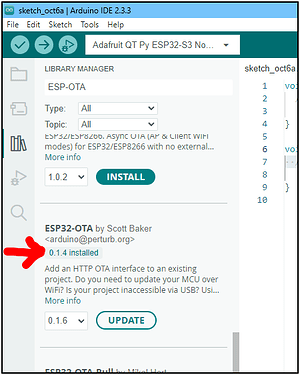

I ran into something odd today. The IDE thinks that a different version of a library was installed in my library folder. When I looked up the library in the IDE it reported as the latest version but what was actually installed was the previous version when I checked the library properties file in the library folder. The only way to get it to update to the latest version was to uninstall and reinstall that library. So, my question is, how can I force the IDE to re-inventory my library folder so that I can see what the actual version of each library I have installed is?

Was that version 0.1.6?
When you say "reported", do you mean the version shown in the Arduino IDE Library Manager?:
Was that version 0.1.4, or 0.1.5?
