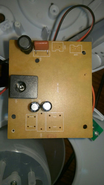

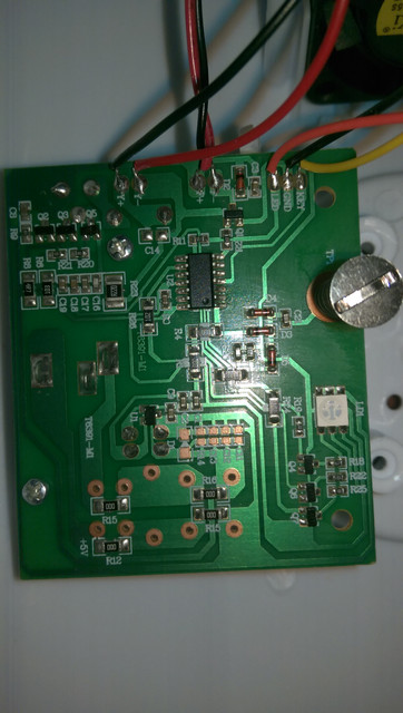

I recently got two identical PCB's which are used for an aroma diffuser. One PCB works and the other doesn't. I took a closer look into the PCB's and noticed that the one which isn't working has a missing transistor, which is present in the other board, and the code in the package states as "RO" or "R0".
Is there any way I can look for the part with this information?

Hmm, not sure about that device, possible damaged BJT. The photo isn't clear enough to follow all the traces alas. The device may be involved in setting output current levels or something like that. Do F+/F- and Y+/Y- go to some sort of motor?
What I notice is that the transistor you circle appears to be blistered.
I would have a sneaking suspicion that on both PCBs, the transistor has been seriously overloaded and on one, it overheated and simply melted its solder connections and fell off!
F+/F- are connected to a Fan, and Y+/Y- are connected to a ceramic disc.

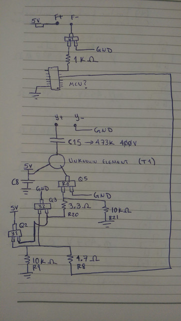

I followed all the traces involved for the F+/F- and Y+/Y- resulting in the following :

Q2 and Q3 form a push pull driver of the base (gate?) of the NPN (N-channel) Q5.
Edit: the measured voltages are neither a bare BJT nor a MOSFET. Maybe it could be a Darlington or a J-FET?
Edit2: You did desolder Q5 from the working or damaged board?
