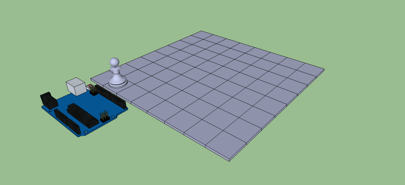

I came here to offer an idea, i didn't come to offer a final solution.
Every idea will have pros & cons, for every idea.
If its expected that every answer needs to be scrutinized, to be a valid response, then this forum which shares ideas, creativity & community interaction ceases to be a place of openness.
Anywho i made a quick picture in sketchup as a visual aid, which helps to look onto to get different ideas.
