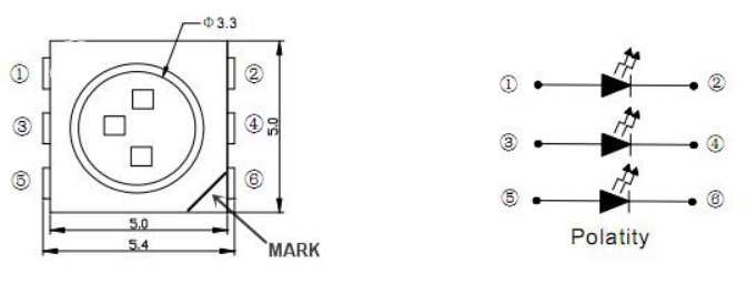

If 5050 is 3 chip led, then is 60mA per chip or per whole LED?
so i want to use some 5050 LEDs in my project, since the 5050 is a 3 chip led, i'm planning to only use one chip, or in other words, one led amongst the 3 leds they provide "per led" if that make sense, the datasheet shows the max current is 60mA, but is that 60mA max per chip or 60mA for all 3 leds combined?
5050 is the format - 5*5mm; can you provide a link to the actual LED you will be using?
here's the specific led im refering to
I see the terminals connect seperately to each chip
In the absence of specific information I'd assume the 60mA is for all three chips.
This datasheet
for a tricolor 5050 shows Ifmax = 20mA per chip
Thanks for the reply, i've also heard the rule of thumb for a led diode is generally 20mA so it should the case.
It depends on the LED!
