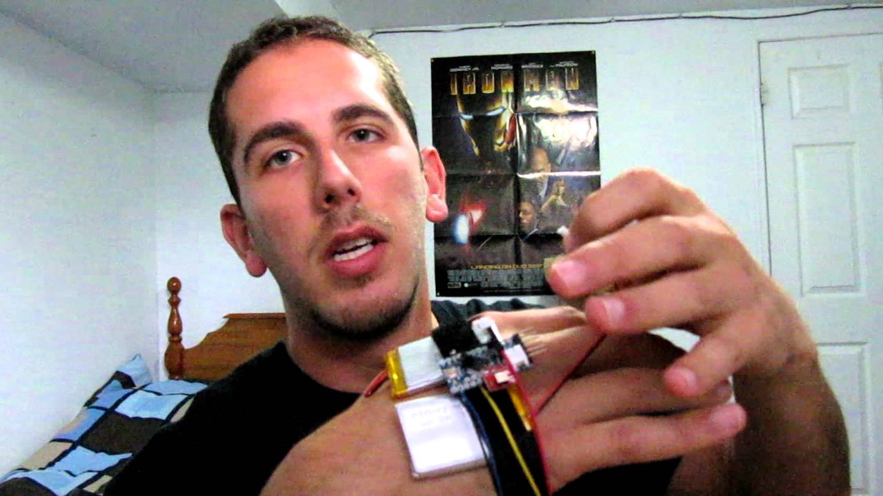

sample video that i want when he didn't trigger the sensor after a few sencond the lights off :))
