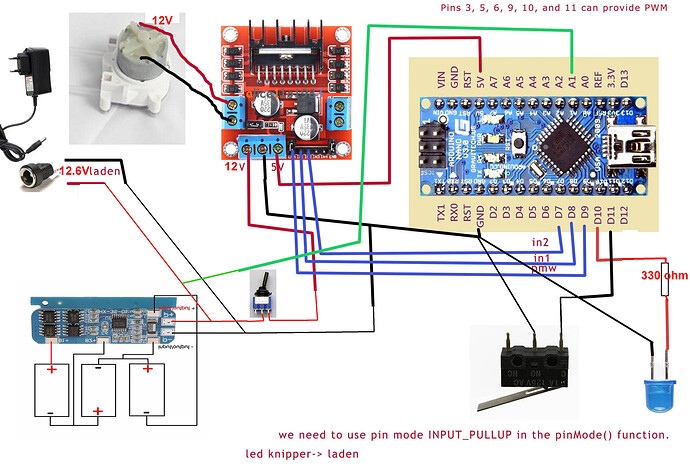

I’m building a small pump system, when the microswitch is actuated the pump should run clockwise when the microswitch is released the pump should run counterclockwise for two seconds.
This is the code I am using but it has a bug. When I switched the main power on, the pump start spinning forever, when I actuate the microswitch it reverses and also spins forever.
Suggestions would be very helpful!
Regards Peter
Here the code I’m using and a link to the schematic:

schematic:
https://drive.google.com/file/d/0B5U4ayHnW98IbWFSamVaTEd4UVE/view?usp=sharing

So let's think about what your loop function does:
First you read the pin, and if it is low then you turn the pump on one way. But if it is not LOW (the else part) then you turn the pump on the other way, delay two seconds, and turn it off. Then the loop function repeats. It checks the pin again. The pin is still not LOW so it does it again, turn the pump on delay two seconds and turn it off. This all happens in a matter of microseconds so you never see the pump turn off, it turns back on too quickly.
I think you should take a look at the "State Change Example" that comes with the IDE. You don't want to run the pump if the button IS high you want to run the pump if it has just BECOME high but it was low the last time you ran through loop. This requires that you remember the last time you read the button. The State Change Example illustrates how to do this.
Any sketch that reads a switch needs to be non-blocking. As mentioned the state change example will help.
You also need to think about the different states your machine can be in. It is always going to have to monitor the switch as that effects the states. One state is that it will be doing nothing except waiting for the switch to be closed. While the switch is closed it will be running the pump and waiting for the switch to open. Then the state will be running the other pump (or backwards) and timing that for two seconds waiting to go back to the state of doing nothing but waiting for the switch to close again. This can all be done by timing using millis. You need to think of things happening in a loop rather than a linear script.

Delta_G Thank you very much you set me on the right track. The code I was using was indeed not very intelligent as you pointed out, it was a forever ongoing loop.
I studied the code you mentioned "State Change Example" and changed it to my situation and everything works flawlessly now.
