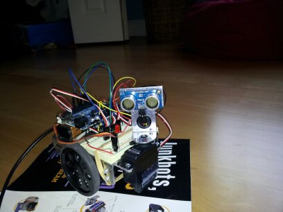

hello , me and my tutor wrote/cobbled this code together (I’m on a media course and arduino isn’t really part of the syllabus to write sonar sensor values to a servo arm.
however it turns out what I need is more simply an if statement so that when the sonar reads in a particular range the servo rotates it’s full 180 degrees.

I’m relatively sure I cut the mapping portion but I’m not clear where or how to write the if statement. sorry if this is too basic a question if so just direct me a page where I can work it out myself. cheers

yes please read it will tell you how to post code to increase readabilty.
this
http://arduino.cc/en/Tutorial/Ping?from=Tutorial.UltrasoundSensor
and this
http://arduino.cc/en/Tutorial/Sweep
and finally this
http://www.instructables.com/id/How-To-Make-an-Obstacle-Avoiding-Arduino-Robot/
