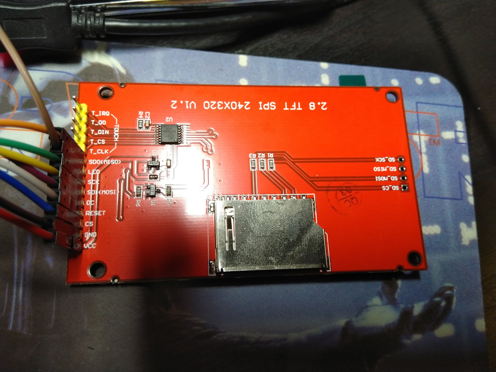

Hi David,
thanks you for replay and I am sorry but I was off for the weekend. Well, I attached two pictures of the connection at the and of this post, but honestly, there is not much to see there. There is no hand made soldering, everything is factory made. But one can check the right cable placement by cable coloros from these pictures. The STM32 device is STM32L031K6T6 sitting on STM32L031K6-nucleo board.
connections are as follows:
CSN is pin PA4 on STM32 ( pin A3 on nucleo) - blue cable
SCK is pin PA5 on STM32 ( pin A4 on nucleo) - green cable
MISO is pin PA6 on STM32 ( pin A5 on nucleo) and it is connected to display MOSI - yellow cable
MOSI is pin PA7 on STM32 ( pin A6 on nucleo) and it is connected to display MISO - orange cable
DE is pin PA3 on STM32 ( pin A2 on nucleo) - violet cable
RST is pin PA1 on STM32 ( pin A1 on nucleo) - gray cable
The brown loose cable is from the LED control. Not important for SPI communication. The red and black cables are connected to 3.3V and GND respectively.
I have connected different SPI device (NRF24L01+) with the same cable placement (apart from DE and RST) and communication works fine.
Thanks for any feedback

Anyway, I've noticed interesting fact. Thus, I need to swtich the MOSI/MISO. Originally I thought that MOSI and MISO on the display are display's MISO and MOSI :). But no, they are not. Mark MOSI on display is display's SDI and mark MISO on display is DSO. That means I need to plug MOSI to MOSI and MISO to MISO. Still no change with command 0x04 - Read Display ID. But when I issue cmd 0x09 - Read Display status I can get 0x00, 0x30, 0x80, 0x00 and 0x00. Which is finally something :). But according to datasheet, the most significant bit in third parameter (byte) should always be zero. I'm little bit confused. And also, when I issue 0xA (Read Display power mode) I get first byte (which should be XX..X) equal to 0x80 and the following one is zero. Does this ring any bells to you?

MOSI means MasterOutSlaveIn
The ILI9341 is a Slave. So you connect MOSI to DIN. And MISO to DOUT.

Finally I got it! From LCD wiki:
http://www.lcdwiki.com/2.8inch_SPI_Module_ILI9341_SKU:MSP2807
I downloaded the example for STM32 and 'stole' the init sequence, which is slightly different than adafruit one or than this one:
https://vivonomicon.com/2018/06/17/drawing-to-a-small-tft-display-the-ili9341-and-stm32/
and it finally works! For now, I am able to fill the screen with solid color, but that is the milestone I needed to cross.
