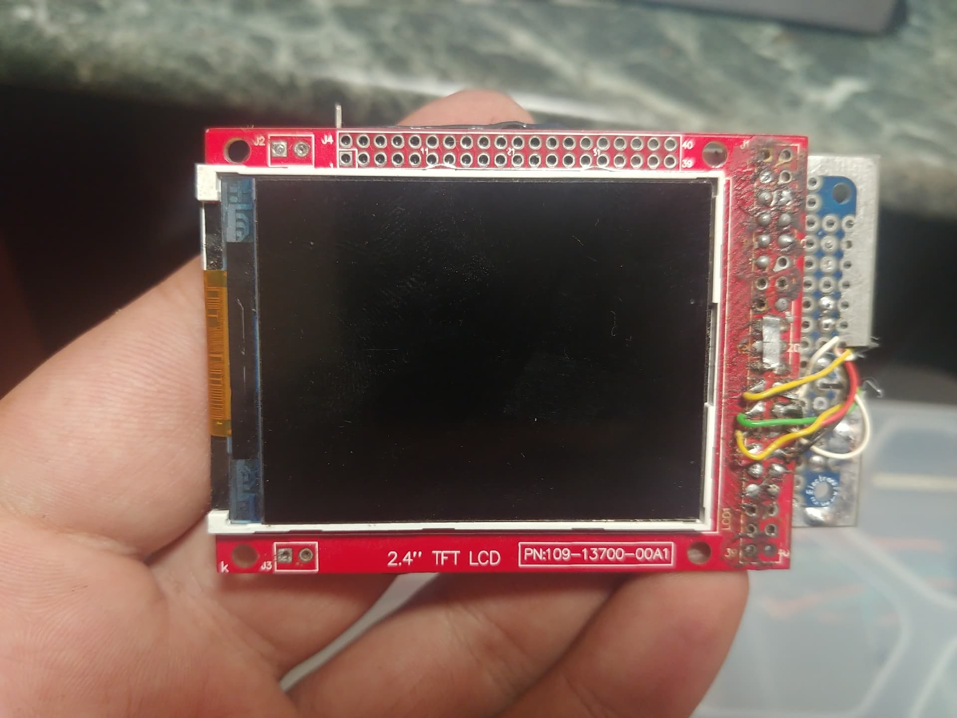

Hello! I have an 8bit SPI TFT display with an ILI9341 controller, salvaged from the DSO138 oscilloscope. I managed to make it work with UNO and wanted to display a picture, but UNO's memory is not enough to store 320x240 pictures. I also have NodeMCU 1.0 and ESP32-CAM with enough memory. I'm using tft.drawRGBBitmap() function to draw pictures, so is there any way to call this function on UNO, with data, stored on NodeMCU?

Can you post a photo of the display?
I soldered it to prototyping board, and turned it into the shield. On UNO it uses pins D2-D9 and A0-A4

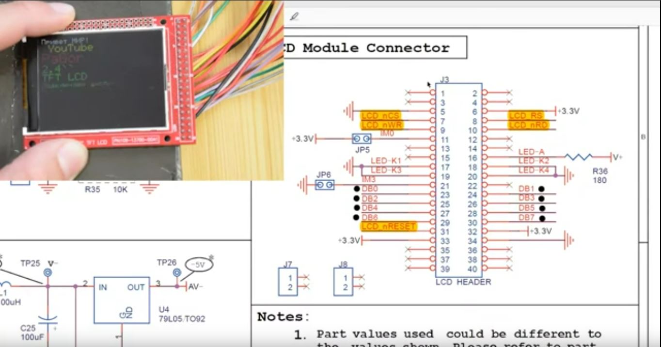

Here's the pinout
Surely it is 8-bit parallel and not SPI.
A Nano-328 has 5V GPIO. Hence you need 3.3V level shifters on all 8 + 5 pins.
A NodeMCU has 3.3V GPIO. But does not have enough GPIO for 8 + 5 pins.
The obvious solution is ESP32. Enough GPIO and enough Flash memory for several RAW images (or lots of JPEG images).
However you can store BMP or RAW pixel images on a regular external Flash chip (or SD card). BMP or RAW images take minimal processor power. e.g. you can display 320x240 RAW images on a 3.3V AVR 8MHz Pro Mini.
You just need to be realistic. i.e. choose a suitable module like ESP32 or STM32.
