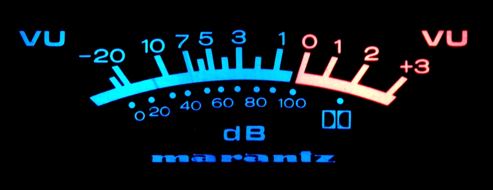

Load an image as a background yes, but have a moving object over it...well, you would have to do some partial repaints of the background image. So if your object is moved to a different location, its previous region has to be repainted with a portion of the background image. Considering the image would be on an SD card, I am not sure how fast you could repaint a region. I'd say you're much better off with a plain color background.
Ok.
What I was thinking of was something like the attached pict and having the needle moving over it
You could draw it all with the libs drawing functions (arcs, lines, circles) and use gText to draw all the text (if you can find the right fonts). If I am not mistaken you should not reproduce the Dolby logo (trademark). But generally speaking, I think the easiest is to use the font editor which is included in the lib's tools folder (you have to use it anyway if you want to generate custom fonts) and draw the logo there. Then print it on the screen with gText's drawString.
One of the disadvantages is that all the lines, curves, text won't be antialiased. You can achieve antialiasing only by using an image. Not sure how big the resulting image will be, but maybe you could fit it in Due's flash/program memory (a big byte array) and draw an image from it (instead of having it on an SD card). I think the refresh rate (draw image, draw needle, erase needle, draw image, draw needle,...) might be acceptable then.

Hi and thanks for your response.
Yeah for the db logo I know, the pict was for exemple.
Ok then I'll dig this way,
