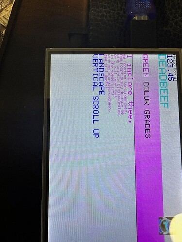

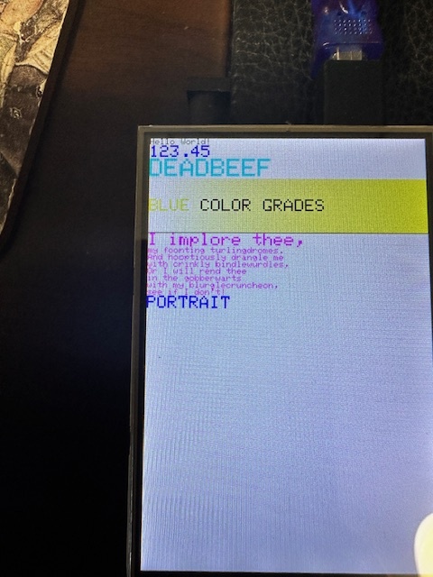

After calibrating it, I was testing it out with the MCUFriend library graphicstest_kbv sketch and found that the colours are displayed incorrectly:
  • Red is displayed as Cyan
  • Green is displayed as Magenta
  • Blue is displayed as Yellow
Shown below Is one of the images showing the output displayed:
I've ensured I have the latest version of the mcufriend_kbv library.

Here are some more images of what the display looks like:
Is it simply a matter of revising the colour values in the software? All the various colours do display, but they just appear to be logically shifted, if you see what I mean.

Two thoughts:
  1. try adding something like tft.invertDisplay(true); or tft.invertDisplay(false); in your setup().
  2. (Less likely IMO): look near the top of MCUFRIEND_kbv.cpp for #define SUPPORT_9488_555. You could try commenting that out or uncommenting it in and see if it makes a difference. I don't think this is the problem, but if #1 doesn't do the trick, it can't hurt to try.
tft.invertDisplay(true); sorted it.
