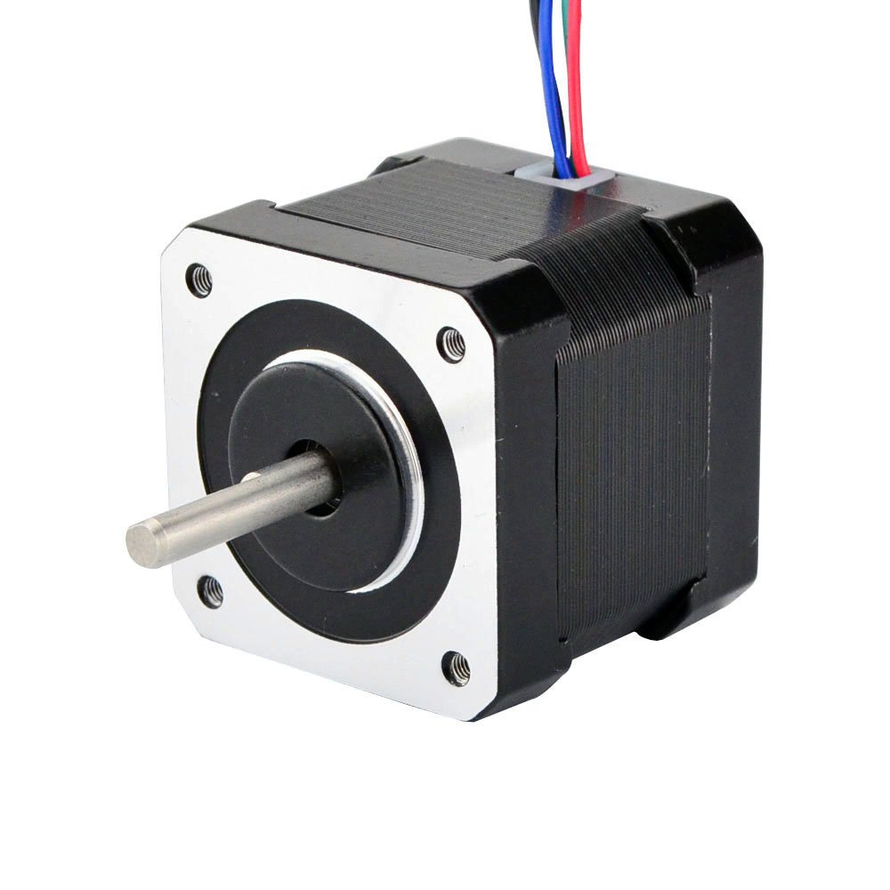

In my current project I’m running this Nema 17 motor which works fine as all I’m doing is slowly turning a geared drum.
I’m looking to see if I can put a larger motor in its place so I can use the same machine as a semi high speed to high speed rock tumbler by switching setting (The code isn’t the issue).

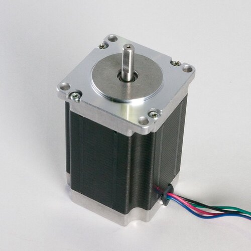

I’m thinking about replacing the motor with this one:
But I’m confused buy how this motor gets such a higher holding torque with a similar amount of power as the Nema 17 (How I understand it is that torque is liner to the amount of power provided to it).
Do you think this motor would work? Any recommendations?

A few points ...
An Easydriver has a max current of 0.75 amps. A BigEasydriver or a Pololu A4988 can provide about 1.2 amps without a heat sink and a Pololu DRV8825 can provide about 1.5 amps without a heat sink. A TB6560 can deliver up to 3 amps. Above that you need more expensive industrial stepper drivers.
For high speeds you need a motor with a low coil resistance and a higher current. I don't think that large Nema23 motor is intended for high speeds. A low coil resistance goes with a low nominal voltage. That motor has a 10.5 volt nominal voltage which means it has lots of turns of wire in its coils. That's how it gets high torque with a lowish current. Also it is longer so it can have longer coils and magnets.
The nominal voltage of stepper motor is largely irrelevant. The important factor is the current. For higher speeds you need to drive the motor with a higher voltage. if you are limited to a 12v power supply you should choose a motor with a low nominal voltage. But be careful to stay within the limits of your stepper driver - or buy a more powerful driver.
...R

Kirkg:
Wrong I'm afraid, torque is mainly limited by motor rotor volume(*) and the properties of iron and copper.
NEMA23 motor has much higher rotor volume so you'd expect much higher max torque.
The magnetic gap size (and magnetic circuit in general) is very important in determining how much
magnetizing force is needed for a given magnetic field strength, and thus the static power consumption.
But it also affects the back EMF and thus max speed of the motor. There is a trade-off to be made.
