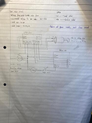

Im planning on using 2 arduino boards for my project. Should I use 2 voltage regulators for project or use 1 for both?
For context, my first board would contain a motor circuit with an L298N motor driver while my second contains a controlled heating system that uses 2 relays with PTC heating elements, DHT11 sensor, I2C LCD display, and 1 12V exhaust fan. My input would be a 12V DC power adapter and I'm going to use it to run the motor, the fan, and the 2 heating elements. Since I want to minimize the chances of my boards from overheating, I want to reduce the input voltage for my board to around 7V, so I want to integrate a voltage regulator circuit. Should I include 2 voltage regulator circuits or should just utilize 1 for both boards?
Edit:
I added some rough hand-drawn pictures of my circuits. They are separated right now but I plan on combining them using the same 12V DC power supply. This is for a DIY automatic composting system project.

Why are you planning on using two boards instead of one and what type of boards are they ?
What you are doing that this is happens?
They are both arduino UNO
I heard that 12V could potentially cause the voltage regulator in the board to overheat and I don't want that to happen so I'm reducing the 12V input from the power supply down to 7V
Yes, that's ok for the input to Vin.
But why will you use two Arduinos?
The only logical reason I can see for you to use two Arduinos is because the two functions being performed are so 'separate' you intend to use off-the-internet codes for both. If that's the case, fine, it does avoid merging the two codes, but it's a bit strange.
The two Arduinos are probably powering their sensors, as well, correct? If so, that's a design limitation that might also force the use of two Arduinos, but it's probably the wrong way to go.
