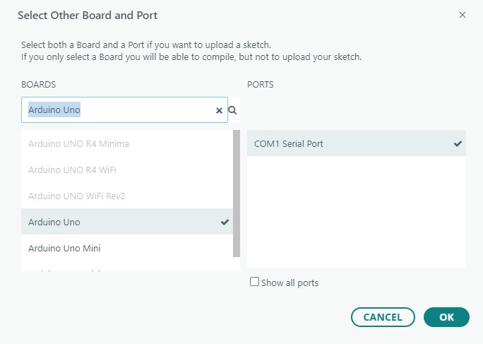

Let me try to understand. I connected the board and tried to upload the program with just some changes in the melody notes. I clicked next to "Arduino Uno" and a little pop-up appeared showing Arduino Uno COM 1 and an option to change the board and port, which I ignored. The sketch did not upload , so I canceled it and the pop-up window showing Arduino Uno COM1 and the other option "disappeared." Clicking on Arduino Uno brings the pop-up window back.
I repeated this process and just disconnected the Board instead of canceling the upload. The pop-up window showing Arduino Uno COM 1 and the option did not disappear. So I'm not sure what you mean by "disappear."
<div class="post-metadata">
**Author:** ![xfpd](https://dub1.discourse-cdn.com/arduino/user_avatar/forum.arduino.cc/xfpd/32/1120236_2.png) [@xfpd](https://forum.arduino.cc/u/xfpd)\

> [@xfpd](#):
> When you post code or errors, you should post the complete code or error in a ` block.`
> [@msmith1](#):
Clicked what?
> [@msmith1](#):
Show the popup.
> [@msmith1](#):
Show this option.
> [@msmith1](#):
Clicking where? Show this.`

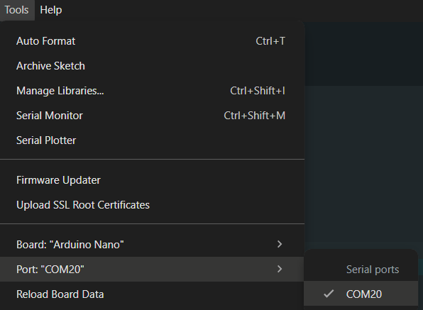

This is for a Nano on COM20 but that is not relevant.
**Connected**
 ![image](https://europe1.discourse-cdn.com/arduino/original/4X/6/4/5/645f10dd31d0ff616287f4d90c38a91cbb1c963d.png)
**Disconnected**
 ![image](https://europe1.discourse-cdn.com/arduino/original/4X/3/6/9/3699c44eb84afccffd1dd6a22bd47976f0cd12f7.png)
The port option is greyed out and you can not select COM20 if you click on the `>` next to it.
Your description sounds like you can still click on the `>` next to COM1 and see that (like the COM20 in the first screenshot).
If so (COM1 is still visible after disconnecting) COM1 is not your Arduino.
In which case you need to dig into Windows device manager to see what is happening there.

Yes, I seem to be able to edit and look into COM1 even after disconnecting (see attached), but according to the Device Manager, which shows only COM 1, the port is working properly.

If it does not disappear from device manager when the board is disconnected it's not your Uno.
Depending on the computer hardware COM1 can be (and in the past always was) a serial port on your motherbiard.
There are 2 possible reasons that Windows does not see your board
1. Faulty USB cable.
2. Faulty 16U2 (the IC closest to the USB port).
//Edit
3rd reason is that your PC hardware is broken.
