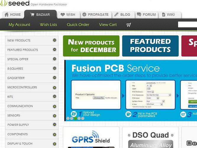

I use seeedstudio and used iteadstudio some years ago. It sounds like itead has not updated their ordering system a bit. Now with seeed you can upload files. I have a tutorial for them. Same price as itead and free shipping for orders over $50

Same price as itead
yea, they all go to the same place, fusion pcb, so they have their standard rate for a x/y panel which you cant deviate too much from cause every body and their brother is acting as a broker
Rumor has it that they use the same fab house.
