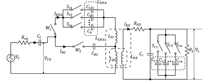

First, I am designing a wireless power transfer system. In order to manage the energy generated, I have integrated an energy management system using relays and ultrasonic distance sensor to read the distance of the receiver from the transmitter coil. The general system is my profile pic.
For the last question, I am learning to be perfect in Arduino programming and applications.
Thanks
There are 3 sets of relays: 2 x 4 relay array and 1x2 relay array. The 2 x 4 array are for impedance matching while the 1 x 2 array controls the toggling of the transmitter box as shown

Here are the diagrams. In wireless power transfer, the transmitter (Tx) and the Receiver(Rx) are separated by distance (d). In this design, I am designing a self tuning impedance matching system that seek to maximize the power transfer at distances before the maximum allowable distance.

Here is the general diagram:
This is a prototype so the power is not relevant at the moment.
The two capacitor banks (Tx(IMN) and Rx(IMN)) are designed to do the automatic tuning for maximum power at every distance greater than SP(Switching Point). SP from the system is a point of intersection and transition where a Single-Coil transmitter (SC) and the Electromagnetic Halbach array (EHA) transmitter meets. So the system is an integration of SC and EHA depending on the distance between the receiver and transmitter as seen in the diagram. The two relay array is used to toggle between the two systems (SC & EHA) . If d<= SP, we have SC WPT and a single optimized capacitor does the transfer process. If d > SP, we invoke the tuning of TX(IMN) and Rx(IMN) resonance unto max power transfer at the receiver. During the tuning, each power obtained and the tuning values are stored as binary bits. They are then compared for the max power at Tx(IMN):Rx(IMN). This values are held for that current distance.
Here is the capacitor bank using relays
