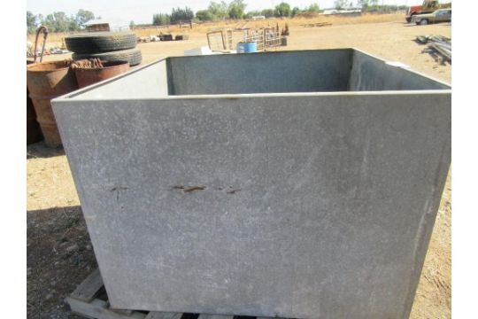

Imagine something similar to this: https://cdn.globalauctionplatform.com/4d0f3676-e6e4-4c0c-ae24-a532016ae087/e48ca3af-7e6f-4c3d-9a1c-a53501097fa1/540x360.jpg
Where certain specific properties have to be measured from the inside, with the top having to be sealed off (but with a non-metal material). Extended an antenna through the top isn't possible, and cutting through the material is an absolute no-go.
I have seen similar devices meant for an application like this, so I know it's possible. Perhaps it takes a very specific antenna design taking the properties of the material into account?

Your image looks like a bog standard galvanized steel water tank.
Obviously you want to do something other than store water so tell us what you are actually doing.
