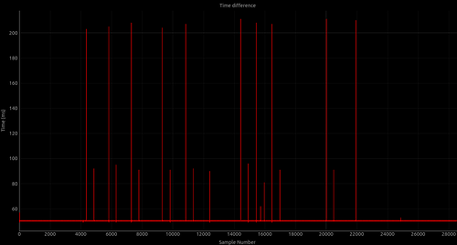

Hello everyone,
I have a FSM that is designed to record two samples to a file on the SdCard at 20-Hz. For the most part the program runs without any issues except I occasionally get some outliers of +200ms in post processing review. It is random and can show up in sample sizes ranging from 500 samples to 28,000 samples. I am sure it is something in my code but I don't know where I should focus. This is my first time using SdCards so I thought it would be best to post here.
Some information on the project:
- **Board:** Arduino Uno
- **SdCard Shield:** Adafruit Datalogging Shield
- **SdCard:** Toshiba 2GB SD-C02G JAPAN
File Structure Format:
millis(), ADC Value 1, ADC Value 2
I am checking the frequency by performing millis()n+1-millis()n in post processing and this is where I am finding the anomalies.
 ![](https://europe1.discourse-cdn.com/arduino/original/4X/f/0/a/f0abc1aab81c33332f43d28bb39ec1fad1bb4ac6.png)
Am I misunderstanding the buffer therefore causing the issue? Or is it something unrelated to SdCard use in general?

I suspect those occasional delays are occurring within the SD card. The SD card controller does all kinds of stuff behind ths scenes, including erasing blocks of sectors before writing data, and moving stuff around when wear leveling. And those things can take a lot of time. Also, I can't think of anything in your controller that would cause delays of 250ms.
My guess is the only way to be sure no card delays cause data collection problems is to have two buffers, with all the data collection being interrupt driven, and the loop() doing nothing but waiting for a buffer to be filled, then writing it to the card while the interrupts are filling the other buffer. Each buffer would have to be large enough to hold 250ms or more worth of collections. A convenient buffer size, if it works, is 512 bytes since data has to be written to the card in that size chunk.
Edit: Your card info data says your data structure isn't aligned with the erase blocks of the card, and suggests you reformat using the Formatter provided by the SD card association. That might make a difference in performance, and would be worth trying.

> ShermanP:
I saw this too. Today I used the recommended program to format the card but it didn't resolve the issue in that the results are similar to before; not better but not worse. The format did change from fat32 to fat16. Here is the new output from SdInfo from the SdFat Examples.
```arduino
init time: 76 ms
Card type: SD2
Manufacturer ID: 0X2
OEM ID: TM
Product: SD02G
Version: 3.8
Serial number: 0X934F70A9
Manufacturing date: 6/2009
cardSize: 1967.13 MB (MB = 1,000,000 bytes)
flashEraseSize: 128 blocks
eraseSingleBlock: true
OCR: 0X80FF8000
SD Partition Table
part,boot,type,start,length
1,0X0,0X6,137,3841911
2,0X0,0X0,0,0
3,0X0,0X0,0,0
4,0X0,0X0,0,0
Volume is FAT16
blocksPerCluster: 64
clusterCount: 60022
freeClusters: 59978
freeSpace: 1965.36 MB (MB = 1,000,000 bytes)
fatStartBlock: 138
fatCount: 2
blocksPerFat: 235
rootDirStart: 608
dataStartBlock: 640
In \_writeState, I notice that my buffer length only reaches a max of **463**. I changed the condition statement to 512 just to see what the max would be and printed the result to serial. I guess the 463 is not including the \n trailing null character.
```arduino
      case _writeState:
        _currentState = _writeState;
        digitalWrite(ledRecord, HIGH);
        Serial.println(buffer.length());
        if (buffer.length() >= 512) {
          dataFile.write(buffer.c_str());
          buffer.remove(0);
          dataFile.flush();
        _currentState = _readState;
I haven't explored interrupts yet to this level, but I am wondering if this expectation of 20-Hz samples is beyond the scope of how my code is written. I have read about the binary high frequency sampling programs but I like the human readability aspect of the raw file on the SdCard.

The Toshiba 2GB SD-C02G is an older design SD card with a smaller and slower internal buffer compared to a newer 16GB or higher capacity card. I'm currently building Arduino based dataloggers recording 8.8KB/sec in CSV format. When I tested my older 2GB SD cards they took 125-250 ms to do an internal block write. The newer 16GB SD cards, I'm currently using, do an internal block write in 10-25 ms. The randomness in your data suggests an internal card process, possible erasure of data before a write. I suggest using a newer SD card.

Spacejohn, do you do anything in your code to keep SD internal functions from becoming blocking events that prevent data generation from occurring at strict intervals? It just seems at some point you're going to be waiting on the card to finish erasing, or wear leveling, or whatever. That's why I was thinking of generating the data through timer interrupts so they would take place at a fixed interval. And with multiple buffers, you could be filling one up via the interrupts while the other is being written to the SD card in the main Loop(). I believe writing to the card, or waiting for that to complete, could be interrupted with no problem.
There might be other things you could do to keep everything from slowing down. You could start out with an erased card, and maybe create the file in advance, making it very large so that all the FAT entries and directory entries don't need to be made. The other thing that I keep seeing that I think is bad is closing the file after every write. That just creates a lot of extra reading, erasing and rewriting.
Kinser, 512 bytes is important because that's the sector size in the SD card. If you use a different size buffer, you will cross sector boundaries, which may result in needing two erasures to complete the write. Of course your FAT library will make every attempt to buffer things into 512-byte blocks so long as you don't insist on flushing everything and closing the file. But no matter what you do, all the extra stuff the card controller has to do makes SD less than the ideal medium for fast data logging.

The other way to do it (without interrupts) is to use the yield() function. SdFat.h will call yield() when it's waiting for the card to do something.
Be aware that yield() gets called before setup(), so don't attempt to do anything like digitalRead() or SPI.transfer() inside yield() until you are satisfied that setup() has been run. Use a global variable.
SdFat may leave the card's CS activated when yielding, but it's not actively using the card so you can de-select the card and use the SPI bus for other purposes - just remember to set it back before you exit yield().

Ok there is a lot of information here I need to digest in the previous post but first let me address the change in SdCard.
Per SpaceJohn, I changed to a different card I had which is a Kingston 8GB SDC10/8GB. I formatted the card with the [sdcard.org](http://sdcard.org) program and then ran the SdInfo.ino program. The init time is substantially lower (from 76ms to 3ms).
```cpp
init time: 3 ms
Card type: SDHC
Manufacturer ID: 0X41
OEM ID: 42
Product: SD8GB
Version: 3.0
Serial number: 0XC3045500
Manufacturing date: 1/2015
cardSize: 7969.18 MB (MB = 1,000,000 bytes)
OCR: 0XC0FF8000
SD Partition Table
1,0X0,0XB,8192,15556608
2,0X0,0X0,0,0
3,0X0,0X0,0,0
4,0X0,0X0,0,0
Volume is FAT32
clusterCount: 242944
freeClusters: 242941
freeSpace: 7960.69 MB (MB = 1,000,000 bytes)
fatStartBlock: 12586
fatCount: 2
blocksPerFat: 1899
rootDirStart: 2
dataStartBlock: 16384
The +200ms blips in my data are now in the 100ms range. I did a few short test and the results were as follows:
- 33,000 samples (10 samples greater than 50-ms)
- 7,100 samples (1 sample greater than 50-ms)
- 8,700 samples (0 samples greater than 50-ms)
Is there an oppourtunity in my current code in the \_writeState with respect to checking the length of the buffer?
if (buffer.length() \>= 312) {
As I mentioned before, it is maxing out at 463. I have noticed that the program performs better (fewer instances of +50ms) when the size is larger, and worse (more instances of +50ms) when it is smaller.
A general question, am I exceeding the capabilities of a FSM in this scenario? I bet there are endless ways of writing this program and ultimately for me this was an exercise for me in learning FSM. Before I go buying FRAM breakouts and spending money on hardware, am I at a point with this program where I should be writing binary data or am I still within reason to have readable data at 20hz?
I will keep reading the previous posts so I can digest the information some more. Thank you everyone for your input this is great help so far.
