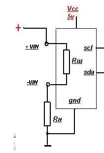

i am trying to use a INA219 sensor to measure current and voltage of a solar panel, but the Sensor just doesn't want to work.
I downloaded the Adafruit Library for the INA219 sensor and tryed the example sketch getcurrent but it did not work. Code is attached below. The Serial Monitor showed "Hello" and stopped. After some testing the Arduino was not able to do the Funktion ina219.begin(). Does anyone have an idea why it did not work.
I connected the INA219 Sensor to 5V and Ground and the SCL and SDA Pins to the SCL and SDA pins of the Arduino Uno.

Show your wiring diagram.
I2C scanner
What did the I2C scanner report?
