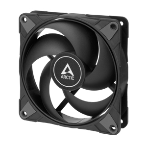

Hi everyone,
I'm setting up a Home Assistant control center in a RAM Promaster converted as an RV.
One of the system to control is a set of 5 PWM fans dedicated to cool the back of a fridge cabinet. The fans are all connected to a fan hub, meaning all fans get the same PWM signal and only one fan reports its speed.
I'm using an Arduino Uno R4 WiFi to read the temperature of the cabinet, to send the PWM signal and to read the RPM.
I used mariuste code to determine the PWM duty value based on temperature ([Fan\_Temp\_Control/code/Fan\_Temp\_Control/Fan\_Temp\_Control.ino at main · mariuste/Fan\_Temp\_Control · GitHub](https://github.com/mariuste/Fan_Temp_Control/blob/main/code/Fan_Temp_Control/Fan_Temp_Control.ino)).
I used Federico Dossena code to read fan RPM ([How to properly control PWM fans with Arduino - Federico Dossena](https://fdossena.com/?p=ArduinoFanControl/i.md)).
Since I'm using an Arduino Uno R4 WiFi, I had to change the PWM commands from timer control to PwmOut as described by pschatzmann in [https://www.pschatzmann.ch/home/2023/07/01/under-the-hood-arduino-uno-r4-pwm/](https://www.pschatzmann.ch/home/2023/07/01/under-the-hood-arduino-uno-r4-pwm/).
After a few days of testing, I found an inconsistency between the PWM duty commanded value and the corresponding fan RPM.
Based on the temperature reading, which is within 0.1 degree of the actual value, the PWM duty varies between 10% and 100%. According to the manufacturer of the fans (Arctic P12 Max), the fans have a range of 400 to 3300 RPM. So, according to fan data sheet, a duty of 100% should equate 3300 RPM, 50 % = 1650 RPM, etc.
I did lots of tests and confirmed the following:
When the PWM signal is disconnected from the fan PWM input, the fan turns at full speed and the RPM reading indicates 3300.
When the PWM duty commanded value is 100%, the RPM reading also indicates 3300.
But when the PWM duty commanded value is lower than 100%, the RPM reading is higher than expected value (ex. at 50%, the RPM reading is around 2000 instead of 1650.)
So, what am I doing wrong?
Please help

**Author:** ![grb](https://dub1.discourse-cdn.com/arduino/user_avatar/forum.arduino.cc/grb/32/1201129_2.png) [@grb](https://forum.arduino.cc/u/grb)\
**Post date:** [March 29, 2025, 10:57pm UTC](https://forum.arduino.cc/t/inconsistent-fan-rpm-reading-vs-pwm-duty/1368723/2 "2025-03-29T22:57:21Z")
</div>
> [@myriaxis](#):
Please link the source on which you are basing the above calculation. The technical information in the Arctic P12 Max User Manual from [arctic.de](http://arctic.de) indicates that the relationship between PWM duty cycle and fan speed is actually non-linear, and that for a supply voltage of 12&nbsp;V, one can expect approximately 2200&nbsp;RPM at 50% duty cycle:
> **[ARCTIC P12 Max - User Manual](https://support.arctic.de/en/p12-max#toc-109)**
> Get your ARCTIC P12 Max user manual. Detailed explanation with coloured schematics, photos, animations and videos.

> [@myriaxis](#):
You get the RPM signal from fan for a purpose - to adjust PWM according to RPM feedback, not according to expectations.
PWM -RPM ratio is not linear, neither is air flow m3/h - RPM relationship.

kmin, thanks for your reply.
I read the RPM only to confirm the fan is turning.
As I mentionned to grb, the spec given to me by Arctic support indicates a one to one relationship between % of full speed and % duty.
With the diagram pointed out by grb, It's clear the PWM-RPM ratio is not linear.
The RPM readings are normal, so case closed.
Thanks again

> [@myriaxis](#):
> they pointed me to this specification ([https://wiki.kobol.io/helios4/files/fan/4\_Wire\_PWM\_Spec.pdf](https://wiki.kobol.io/helios4/files/fan/4_Wire_PWM_Spec.pdf))
Although it is unclear why they thought a specification document would be relevant to your query, this _is_ an interesting document, because it shows that the Arctic P12 Max does _not_ meet the published specifications:
> Fan operating voltage shall be within the range 12 V ±5% V. [p. 9]
> The fan RPM (as a percentage of maximum RPM) should match the PWM duty cycle within ±10%. [p. 14]
In contrast, their own [performance data](https://support.arctic.de/en/p12-max#toc-109) show that at 12.0&nbsp;V, a 50% duty cycle yields a rotational speed that is **65%** of the maximum RPM — while the spec requires that such a high speed should only be attained when the PWM duty cycle is in the range **55–75%** (so that the fan RPM will "match the PWM duty cycle within ±10%").
Perhaps you can ask them about that.
> [@myriaxis](#):
As explained above, it only has to be "one to one" within ±10% to meet the specs.

Thanks grb for your analysis.
Even if the fan doesn’t meet the specs, I’m still satisfied with the performance of the fan.
I chose it for its quietness.
I raised a concern about the RPM reading vs PWM duty because I thought I had something to adjust in my programming/electronic setup. The P12 Max PWM vs RPM diagram confirms the readings are OK, thus my setup is OK.
Thanks Kmin,
I don’t adjust based on expectations.
I use expected values to confirm the values provided/calculated by my programming.
In my case, I had the wrong expected values since I didn’t refer to the published P12 Max PWM vs RPM curves.
