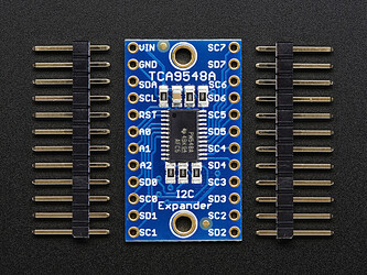

Can you give a link to your TCA9548A module ?
Your link to Aliexpress can be shortened to this: https://nl.aliexpress.com/item/32773684231.html
But that link is useless for me. There are two modules, one with a voltage regulator and one without. The voltage regulator has a voltage drop (0.1V to 1V depending on the voltage regulator), so if you power that with 3.3V, then the sensor gets less voltage.

This is the module I am using:
TCA9548A

The I2C multiplexer module is good. It is a copy of Adafruit: https://www.adafruit.com/product/2717. Adafruit provides a schematic.

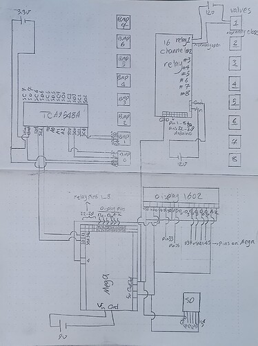

Could you show a schematic with the wiring ? If you draw it on a piece of paper with a pen and make a photo of it, that would be very helpful.
Here is the wiring diagram (sorry for bad painting and handwriting):

The most important wire is missing ! That is the GND wire from the Mega to the I2C multiplexer. I would like that see that along the SDA and SCL.
The 12V circuit for the valves is not connected to the Arduino circuit, that is good. Does the relay module have opto-couplers and are they 12V relays ? So the 12V power for the relays is also not connected to the Arduino circuit ? Nice.
The LCD backlight and the 8 opto-couplers to the relays require some current. You could power the Mega with 7.5V to the power barrel jack or to VIN. Is that now a 9V adapter ? that's fine. Sometimes it is possible to power an Arduino board with 5V.
The next thing is to throw sparks and electric pulses and all kind of nasty things around and trying to melt metal contacts :grimacing: I mean using the relays with the valves. You might need a RC snubber circuit over the relay contacts. Can you replace the relays with solid state drivers ?

Is it not okay to power multiplexer and sensors with an external power source?
Okay, I will connect the Gnd of the multiplexer to the mega.
The 12v supply for the relay is isolated from Arduino, also the relay board has opto-coupler and relays are 12v too, so not only they won't be bothered by 12v supply, but they must be fed a 12v source or they won't work! I tried that before :grin:
Don't know about the RC snubber. I think I'm good with the relay and no need for solid state drives, as no high voltage or current is engaged and the costs are also lower. By experience and reading I found 9v suitable for Mega, opto-couplera have their own power supply, LCD back light has the pin 4 and set the output of 100 to light it up! No potentiometer needed.
Don't worry about melting anything, because the max current passing through a relay is about 500 mAh and a valve or relay won't be low more than 50-100 Mili seconds. There won't be any heat causing the melting.
I'll consider all these, but the thing is I don't see the relay and valves have anything to do with the wrong reading, actually they are almost logically not related to sensors and Mega. They just do what they are told to do, and actually they do it right, they are the best performers of the show :rofl::rofl:
