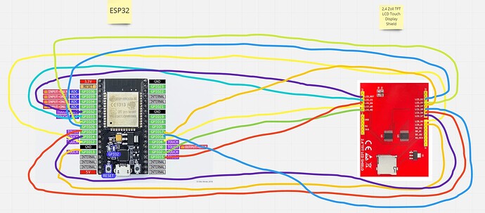

I hope this is enough of a schematic

Dumb question:
Where are your power/ground wires.
Isn't this a shield made for a 5volt Arduino, which the 3.3volt-logic ESP32 is not.

the connections are as they should be
Wawa
November 13, 2022, 8:06pm
7
So you're saying that the Fritzy drawing is not representing what it really is.
Yeah, we get that a lot here.
Leo..
