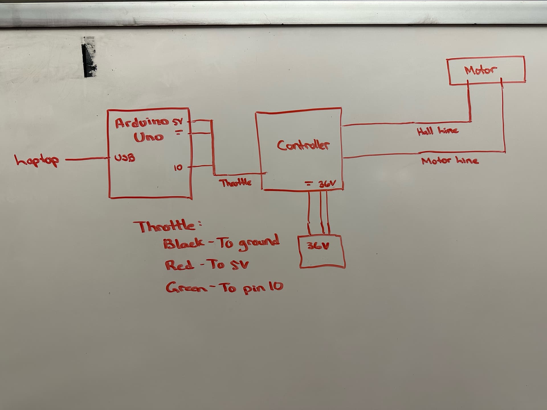

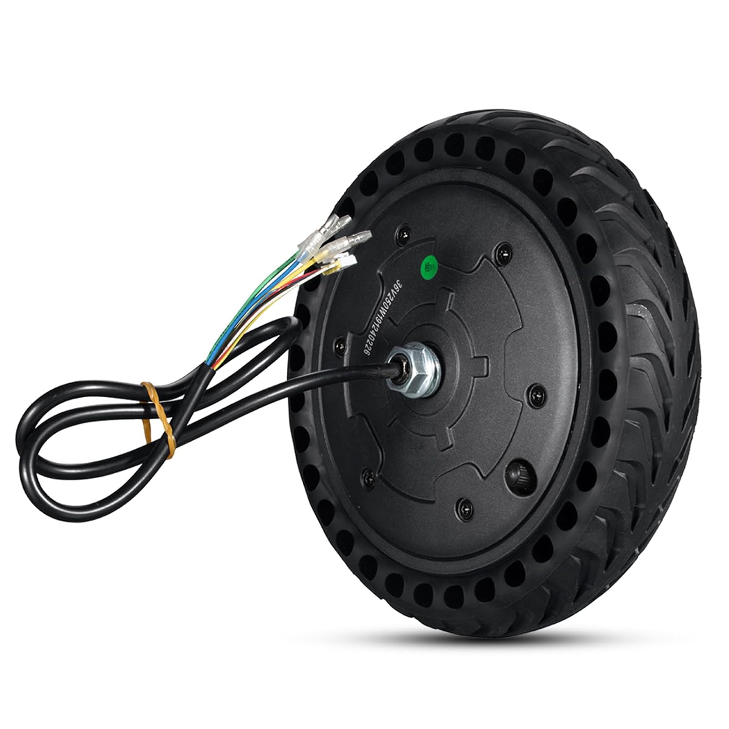

Currently have an Arduino project that will be using two 36V 350W Brushless DC Motors. Attached to the motor are the hall lines and motor lines. I'm using this for my controller. My microcontroller is the Arduino Uno.
I have a problem trying to keep a steady RPM on the motors even with consistent voltage from my Arduino signal line. I've used the analogWrite(pwmPin, rate) with an example of analogWrite(6, 150). However, when running the code with a delay, the RPM changes at every instance of stopping and starting again. I do not know why this is happening. I have everything wired with the hall lines and motor lines all connected properly. My 36V supply is also consistent to which it couldn't be a power issue.

It would be best to post links to your motor and motor driver. Also a schematic drawing of your project.
Which is why I'm here. I could not find any posts that would solve my issue into what and why this is happening.
Only the Analog output works with this motor. I will attach a drawing as well as links to the specific motor shortly.

Here is the link to motor itself:
As for a quick drawing:
After looking for any type of documentation, it appears there are none. I've looked through the reviews and others have stating this is how most controllers are delivered unfortunately. Basically, manufacturers are bent on withholding the exact wiring diagrams and voltage references for each wire on the controllers. All the options and no info on how to utilize them, risking shorting out the controller from experimenting with these wires.

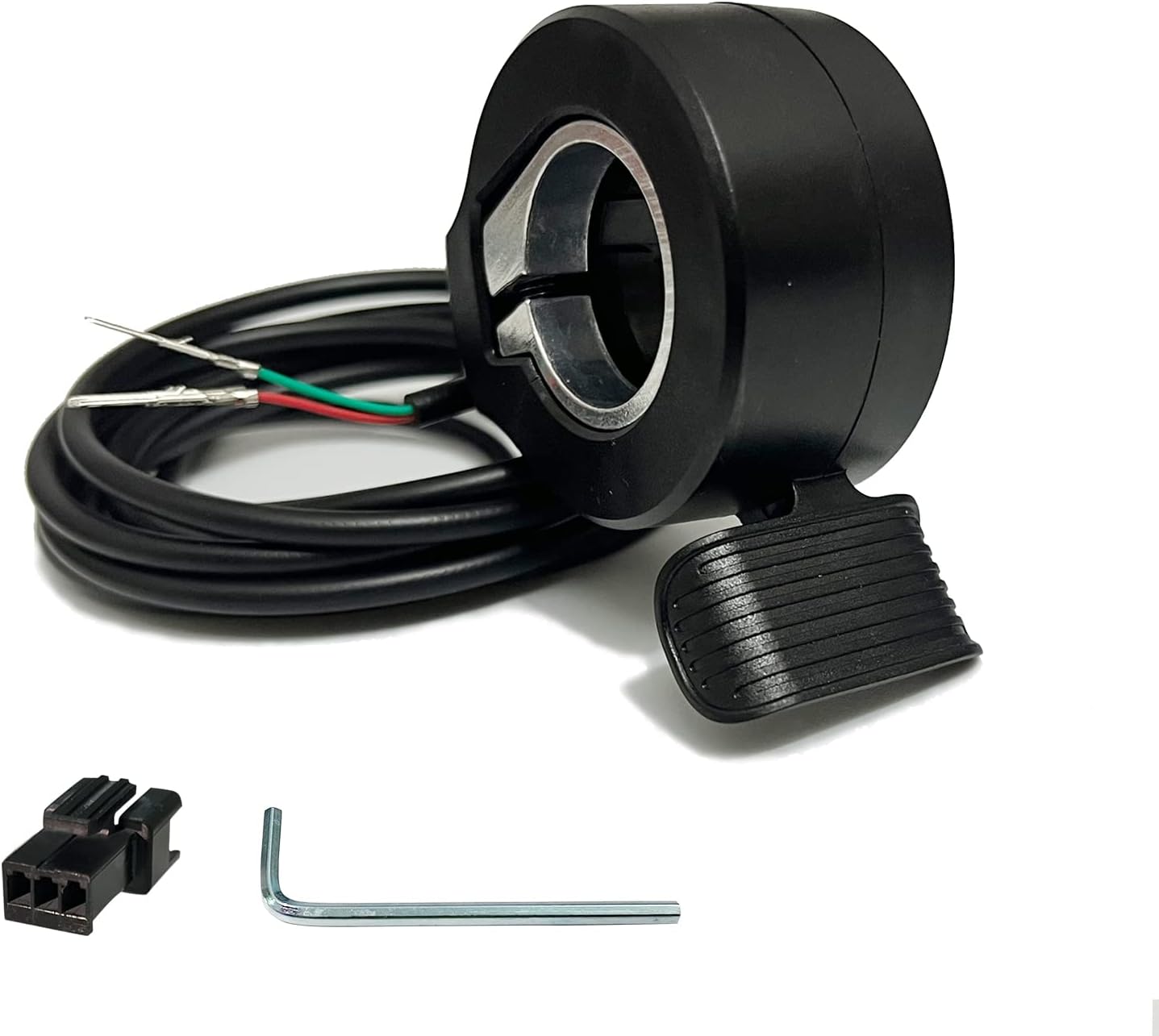

As far as I understand the wiring from the amazon page, you need to use a throttle lever like this one :
Get one and if it works (it should), measure the signal on the various pins. My guess is that red is power supply and green is what remains of it passing through a variable resistor. Disconnect and measure the variable resistor. It should be a new starting point...
