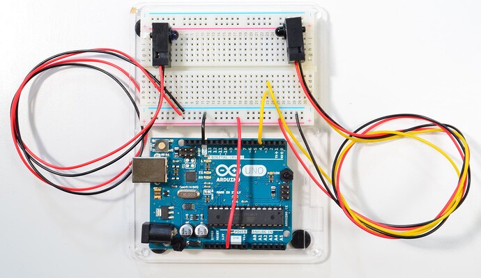

Good evening. I would like to begin by saying I'm new to this type of creativity. I'm involved in a project involving designing a beam grid that has horizontal and vertical lights. Let's assume the frame is 8'x8' square, but the vertical beams shooting down (or vice versa up), would only be from the exact middle out 8.5" each way and the horizonal beams would be from the middle height and extend up and down 10" from the middle up and the same dimensions down. In the last day, I obtained a Arudino Uno board and the Adafruit 5mm IR break beams. By powering the board with a 5v power adapter, I was able to extend the break beams to approximately 50", instead of the known 20". But I really need to extend it to the 8' mark. I have read the Arudino Uno board can accept up to 20v, but if I increate the voltage by obtaining an adjustable power supply and allow 20v to flow, will it allow more power to the beams to stretch further? If the answer is no, what other laser beams would you recommend instead? Thanks.

Thr Uno runs on 5V and can the output pins can output only 5V. The 5V comes from the USB connection or from an on board 5V voltage regulator that is supplied from the power jack or the Vin pin. The maximum practical voltage to the power jack or Vin is around 12V. The amount of current that the onboard regulator can supply is limited and depends on the supply voltage. The higher the voltage the less the current that can be supplied before the regulator overheats and shuts down (best case) or burns up.
If you need to increase the voltage and/or current, use a transistor to switch the higher curren/voltage.
If you want better help, show us exactly what you have and how you are using it.
The Arduino boards need 5V. The regulator on the board can tolerate up to 20V. For a while. All of that excess voltage has to be dissipated somewhere as heat and the regulator is not heatsinked. Power the Arduino with 20V for a few hours, then you will replace it because it's toast.

This is the exact way I set up the sensors. Only differences are I spliced in 8' of wireing on the 2 wire sensor and I powered it with a 5v AC adapter.

Sorry. I confused you since I was confused. In my test here at the house, the IR break beam was losing connection to the receiver as it traveled. The manfacturer said the beam was good for 20" at 3v. When I amped it up to 5v, I had a good beam to receiver at 50". The 8' high and wide frame is required to get it outside of the boxes on each side and we don't want to put studs in closer, at this time if we can find a solution to have the beams or lasers travel from end to end (96"). Today, I put a 12v power supply to the board and it only gave me about another foot. I also think I would have problems with the transmitter and receivers connecting to each other and we would constantly be having to adjust them to hopefully get the aligned to each other. So, n the end, I don't think the IR Break Beam is the answer. I've now looking at the lasers. If you have knowledge, will a Class 2 laser travel 8' and connect to a receiver without an issue? I looked at some lasers and receivers that work with the Arudino Uno board. Shouldn't they work the same way and with a ball enters and interrupts each one or two beams, we could program it to flash a light accordingly? Apologize for all the questions but my knowledge of this type of equipment is void to me. But very interesting also.

Increasing the supply voltage to 20V will not increase your range.
All the components you are using have a voltage rating.
The UNO works at 5V, the IR devices are also 5V and you seem to have reached their limit of operation.
What you also need to consider is the spread of the IR beam, those IR emitters have domed lenses so are not providing a pencil thin parallel beam.
To provide the range, response and precision you will most possibly be looking at quite an expensive commercial/industrial sensor beam system.
