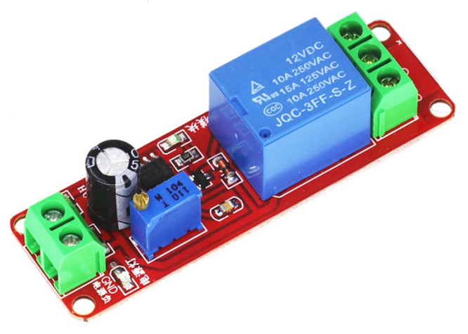

Need guidance on working of Arduino. I am developing an incubator using the following circuit
 ![circuit](https://europe1.discourse-cdn.com/arduino/original/4X/3/0/6/306268984010b4c7c03d1d5a97899dd05600cf11.png)
Here I am using a buck converter of 3 amp rating to reduce voltage to required level for Arduino Uno board and also the ultrasonic humidifier. Everything is just fine until the humidifier starts which is when pin 7 goes high. This pin is not connected any hardware and I have written code to connect pushbuttons which I have ordered online but not yet received. But somehow this pin goes high when pin 8 i.e. ultrasonic humidifier pin goes high. So I wanted to know if there is any internal working I might be overlooking. In the diagram I have't drawn the 12k resistor for each mosfet between gate and source pins however they are present in real circuit. Kindly help me understand the problem here. The following is the code I used -

I even tried asking Chatgpt and it said my code was ok, and I should be checking the electrical connections made.
These are the component I used -
1. Servo MG996r
2. CPU fan 12v dc
3. DHT11 sensor
4. 12v Relay module.
5. 3 IRLZ44N Mosfets to switch relay, fan and humidifier
6. 5v ultrasonic Humidifier 113khz.
7. 5200 mah li-ion battery
8. MP1584 3amp buck converter.
9. 100 watt bulb.
10. 1602 LCD with I2C interface.

mosfet source must be grounded

There are quite a few circuit mistakes.

Can you please tell me why you have attached resistors with each mosfet? i.e. the 220R ?
**The 220R is used to limit the Arduino output current.**
I don't have 10k resistors but I found 12k works fine so I put one across gain and source for each mosfet.
**12k to 100k is fine.**
Also I am using this - Relay Module ([https://www.mantech.co.za/Images/products/555-12VDC-666-200502A.jpg](https://www.mantech.co.za/Images/products/555-12VDC-666-200502A.jpg)) which I am assuming has the reverse protection diode.
**Probalbly, we need to see a schematic of this board.**
I see that you have changed the pin allocation a bit.
**If I did, it was in error.**
I have referred code individually for each component from other sources and tried to put it together. I would happy to simulate the whole thing online but I don't know of any resources that could help. I have tried creating this using [wokwi.com](http://wokwi.com) but there aren't required components. One thing I want you to know here is that when I start the system (using spst 6 amp switch) sometimes it starts and stops and sometimes it works for a longer duration.
**The SPST switch needs to be added to the schematic.**
**Have not looked closely at your sketch; this might be as a result in floating inputs.**
