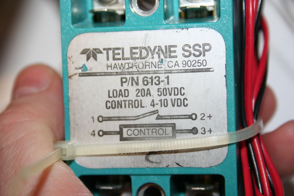

A friend gave me this relay (Large external type) that directly controlled the 12v line from a 5v switch side. It's crazy overkill, but it works, and I know which end is up :smiley:
I was presuming that this same thing could be done in a smaller part.
http://www.lasivian.com/coppermine/displayimage.php?pos=-3726

Plugging that direct into your Arduino is liable to kill the Arduino.

Our friend, lasivian, has a solid-state relay with a DC output. Anyway, it CAN be controlled by an Arduino output (directly) --
Input (Control) Specifications:
Input Control Voltage Range: 4-10 VDC
Output Voltage Rating: 50 VDC
Input Current at 5VDC: 10 mADC Typical, 15 mADC Maximum
Must Turn-On Voltage: 4 VDC
Must Turn-Off Voltage: 4 VDC Maximum
Isolation (Input to Output, Input to Case, Output to Case): 109 Ohms
Dielectric Strength (Input to Output, Input to Case, Output to Case): 1500 VAC(RMS) 60 Hz
Capacitance (Input to Output): 15 pF

Yeah, that's what I'm trying to find in miniature :slight_smile:
Here's a mfr. link to lower power SSRs (DC) with a much smaller footprint --
http://www.crydom.com/en/Products/Catalog/AdvancedWebPage.aspx?CategoryText1=PCB%20Mount&CategoryText2=DC%20Output&SBCatPage=
Ah, sorry, didn't realise it was an SSR. You can forget pretty much everything I have said then :stuck_out_tongue:
