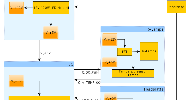

That makes thing easier the bottom elements need to reach a temp of 250c monitored by thermal couples at a ramp rate a 3c sec one led should be on off to show ramping those will show progress of ssr working another led shows the system has power and is working another led show show bottom has reach set point and is stable. I have three ssr thats three ssr leds one for power one for stable temp. A botton press to start system but not start the process . Botton to start process and one to just interupe the process. The top heater will be infered bulb. Any sugestions lary

Looks like Edmar has done all the work for you at the above link i gave.
Yes edmar has done great things with this the only thing missy is im gping to be using push buttons. And my last post was done before i seen the replys i do appoligize for that edmar desighn alot of my specs are off that the bottom heater i and top heater i want controlled by the ardriuno i dont know if that makes sense larry thank you for you one post for doing mutiple processes with the ardiuno im reading it tonight will post back when done reading it and may i post your name in my credits when done with the project

Okay basically a reball machine uses bottom and top heat to melt soider in a ball grid array so the chip can be removed safely with out causing stress to nearby components and the chip the most popular that most people hear about is ps3 or xbox 360 red ring. That the most simple example there are other uses for this machine just saying one specific example
Ah right, now I understand. Do you, perchance, have a reflow oven? I'm thinking that maybe you could put the whole board in the oven with a some kind of mechanism that will lift at the appropriate part of the cycle.
It may seem like overkill but if the whole board is in the oven, it should minimise stress to nearby components.
