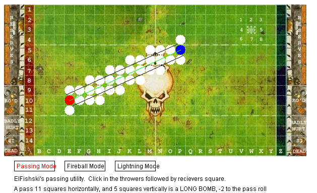

The premise of this is a football board game, which involves forward passing, like gridiron. All these LEDs are in order to allow the board to beautifully illustrate whether a pass is a quick pass, short pass, long pass or a really long pass (long bomb).
Does the lighting have to be part of the switch?
No it doesn't - but the lighting was going to be dependant upon the switching. I am trying to build a real world example of this little web app:
http://www.bloodbowlonline.com/InterceptionApplet.shtml however with a lot more features.
Screenshot (of the web app):
However rather than text to tell you whether a range is quick, short, long or long bomb, I would like the LEDS to light up with different colours like this:
I coded up the logic in excel to make sure that I could figure out lighting up the correct cells.

So basically, as the game plays out, if you want to pass the ball I had originally envisioned pressing a "Pass" button at the side of the board, then pressing the switch on the source square and it would light up the squares with the appropriate colour to indicate the range. You would then press the destination square, and it will then light up the path between the two squares to indicate that the ball could be intercepted along that path (as per the web app screen grab).
