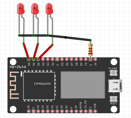

Can you show a photo that illustrates where the burning took place?
nodemcu_schema
This was the entire circuit connected to the board. The resistance was around 500 Ohms. While the board was connected to the PC, everything was fine. Then I tried using a power bank, and the NodeMCU started rebooting in a loop. So I tried with a brand new and working Type-C phone charger, and the NodeMCU started working. However, after 10 minutes, the LEDs started flickering, lost brightness, and eventually everything turned off. In the end, it was impossible to see any sign of life from it.
