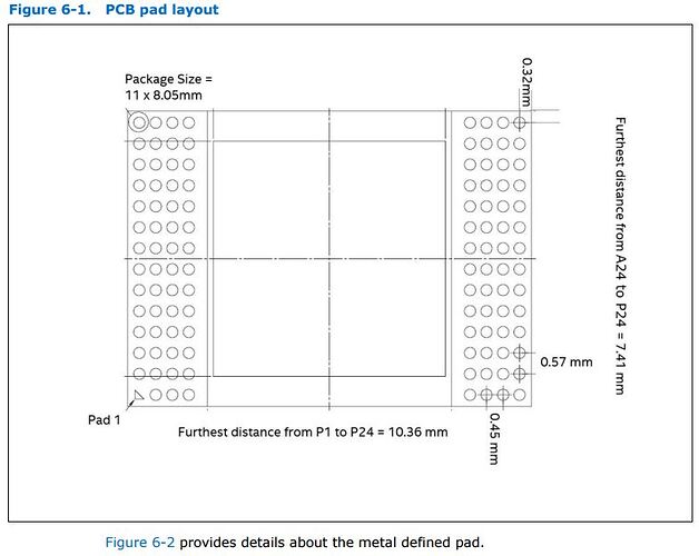

If you look at section 6.2 you will see the following PCB pad design guidelines:
  1. pad size: 10 mil (0.254 mm)
  2. pad type: metal defined (MD) - traditional dog bone Via to BGA-Pad
  3. no non-critical to function (nCTF)
I've attached an image of Figure 6-1: PCB Pad Layout
This new information seems shows that my choosing 0.25 mm (~10mil) and Metal Defined (i.e. Stop larger than Pad) was indeed the correct choice.
I chose to make the Cream 0.02 mm larger than the Pad from what I had read online, specifically Note 5, page 7 of this document:

Here is an updated EagleCAD symbol and footprint for the Intel Curie.
Note that pad 1 of the Intel Curie does not have a ball, so my and Ghost's previous footprints were not correct.
intel-curie.zip (3.83 KB)
