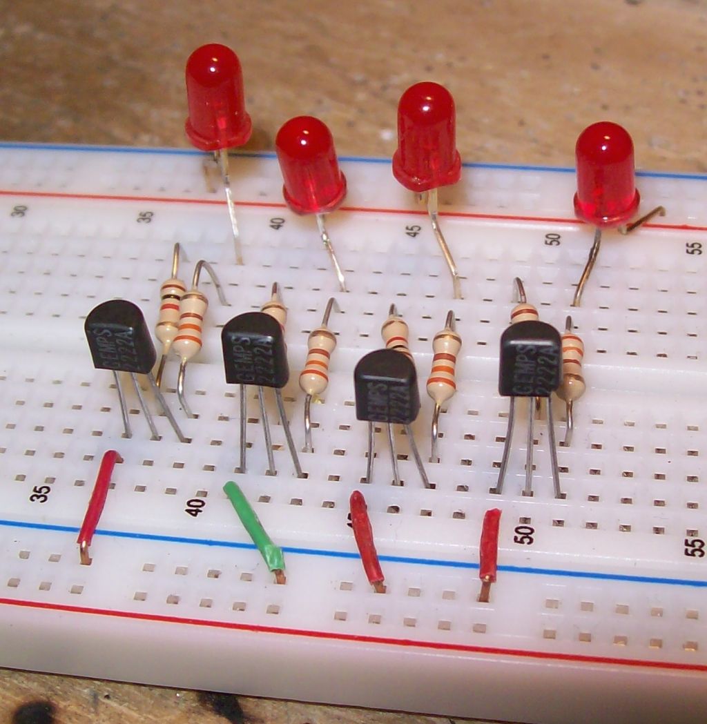

I'm trying to calculate the resistor for my bright leds, but I don't know the max current and voltage of it.
Do you know what the max current and voltage is for a normal bright led?
It depend. Check the datasheet of the led. Some type are 10 mA, 20 mA, 2 Vled, 3 Vled, 1.8 Vled....If you REALLY want to go for MAX value of an led, pass 20 mA, well use a transistor to control the led. With a base resistor of 1 K to 4.7 K, that will be safer for the Arduino digital pin and the transistor will switch the led with at higher current. If something goes wrong, the transistor will be "bye--bye" not your Arduino.
Here a picture.
Thank you for the tip!
