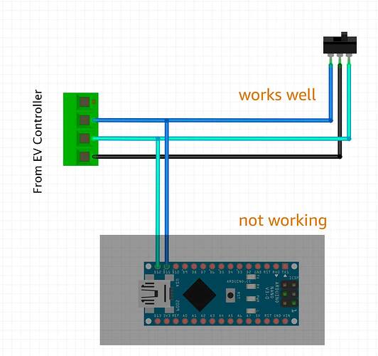

Hi All.. I am stuck on an EV project.
Basically (for whatever reason) I can't get data from my EV controller, and I have to resort on "intercepting" signal with my own way. So far I got speed from "vss pulse", amp draw from current sensor, and some opto-module to get various state of light switches (turn, high beam, etc.). Everything is "passive" (parallel) and can work without the arduino.
The one that baffle me is on how to get the mode switches.
The way the controller works in changing mode is to simply connect mode cables to ground (see picture atttached).
When they are not switched/connected to ground, it reads 1.2v –this is measured between Arduino pin 12 and ground. But Arduino digitalRead() returns 0
And when I switch/connect it to ground, pin 12 reads 0v.. but digitalRead() still returns 0
Can somebody explain why or how can I tap into this cable?
I really just need an on/off state, nothing fancy.
*thanks in advance
You need a common ground between the Arduino and the ev controller.
1.2V, assuming you have measured that correctly, is not enough to register as HIGH for an Arduino digital pin.

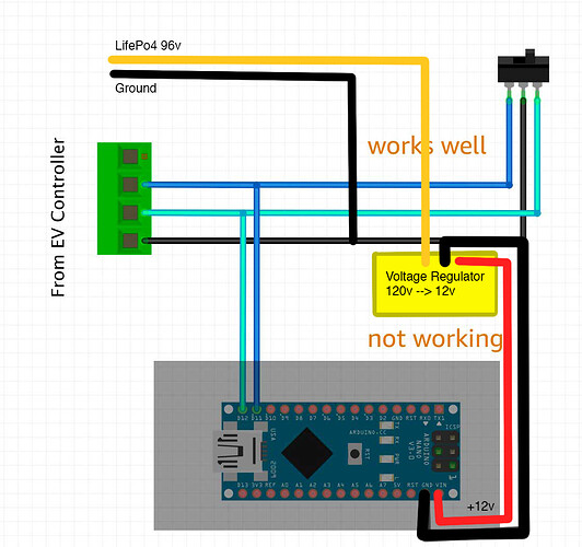

Sorry I forgot to mention that: All circuit has common ground (the same battery)
The arduino runs via a voltage regulator which has common ground.
1.2v not enough to register as HIGH <-- This answers it.

Are you still having problems? I am willing to look at this, if you post a proper diagram that someone could read...

Use analog inputs, if you can spare them. If not, use analog comparators such as LM392N or similar. LM392N has 2 comparators in an 8-pin dip. You will need a couple of resistors as a voltage divider (eg. 10K & 47K) to make a a voltage of perhaps 0.8~1V to compare with the signals from the ev controller.

The one not shown is only the voltage regulator.
I will try the analog route for now.
Seems like I have enough pins for that.
Can you post a diagram with the regulator in it?
Have you included bypass capacitors at the regulator if it is a linear type?

"Circuit" with voltage regulator is attached.
As it appears, it was really because "1.2v not enough to register as HIGH"
I am now feeding the cable through analog pin, and simply put an if-statement. It is probably not the best way to do it, but I figured I have 8 precious analog pins on my Nano, why not splurge it on 3 simple on-off reader :smiley:

Can you post an updated circuit diagram, labelling Mode E B and R pins?
What are you using as your voltage regulator?
Do you have a fuse in the 120V circuit to protect your project?
