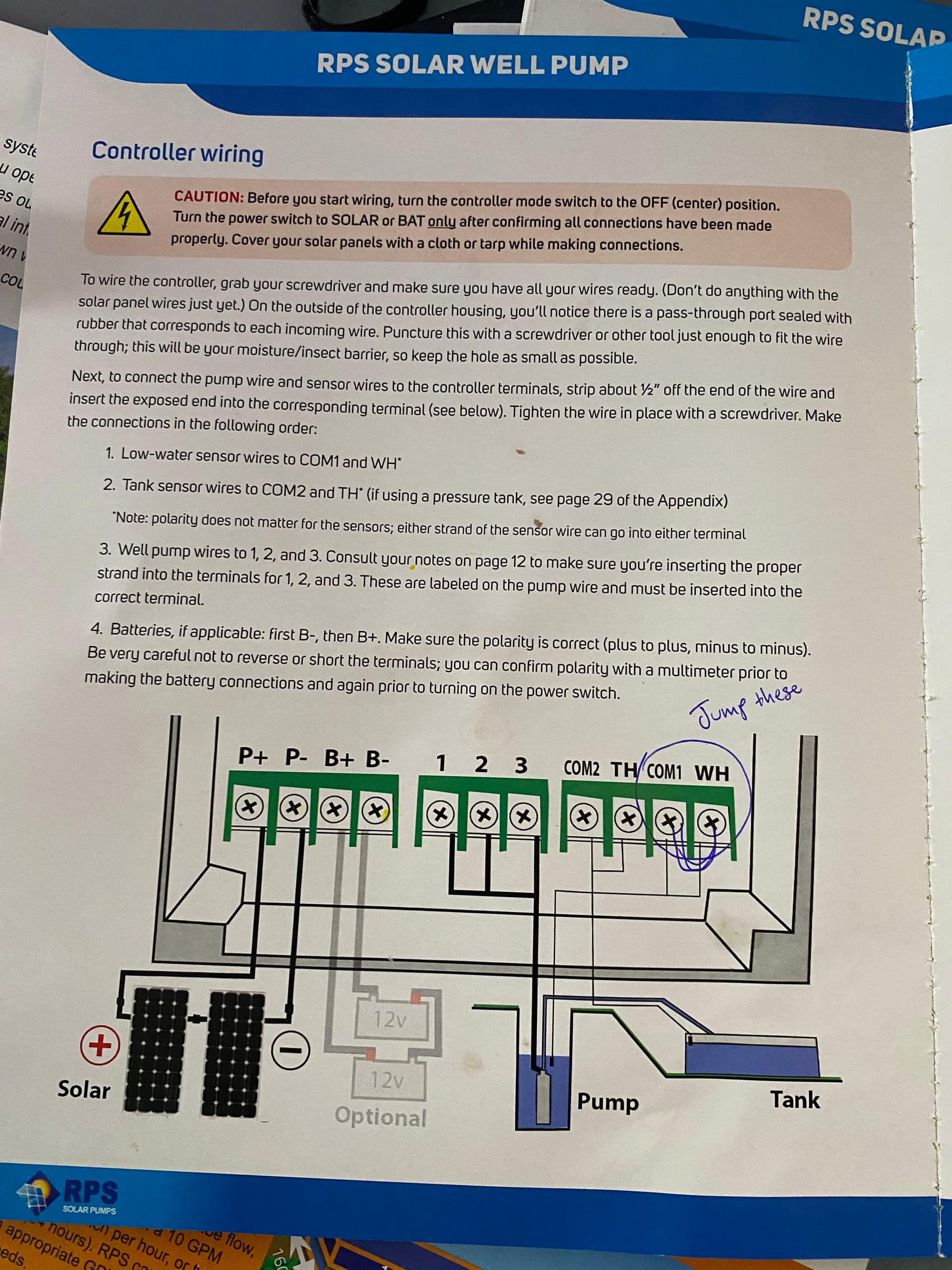

Well...this was the best I could get...they won't release the board's schematic for "proprietary/competitive" reasons...might it be possible to tie into the COM1/WH terminal as that's where the sensor ties into? Ignore the "jump these" comment as she said that was a note to a different customer :wink:
Additionally in the brochure from the other day, it does note the tank and well sensor "normal" status...
â—Ź Tank Sensor - 2 Terminal, Normally Open for Tank Full Detection
â—Ź Well Sensor - 2 Terminal, Normally Closed Terminals for Run-Dry Protection
â—Ź Speed Dial for GPM Adjustment
â—Ź Low Well Timer Dial - Set up to 30 min delay after low well condition is resolved
â—Ź 3-Way Exterior Shut-off Switch (Solar,Battery, Off)
â—Ź MPPT Pump Function (Maximum Power Point function is used to optimize the running of the pump motor with variable frequency based on available power)
â—Ź Pump Terminals (Labeled 1, 2, 3)
â—Ź Over Voltage Protection Diode

To safely interface the switch connectors so that an Arduino can read and report the status, you MUST know the voltages present when the switches are open. Did you see this comment above?

Disconnected means "not connected".
Connect the controller to an appropriate power source. Then, with nothing connected to the controller switch terminals, use the probes on your multimeter to measure the voltage between each switch terminal and ground (common).
It would also be informative to measure and report the current flow between each switch terminal and ground/common. It will probably in the range of a few milliAmperes (mA).
My question was on the "switch closed", not "disconnected"...I was trying to confirm if that's what the phase switch closed" meant.
The "switched closed" (or "short circuit") current flow can be measured using a multimeter on the current setting.
Either insert the multimeter into the switch circuit and close the switch, or disconnect the switch from the controller and touch the multimeter probe tips to the controller Switch and COM terminals.
