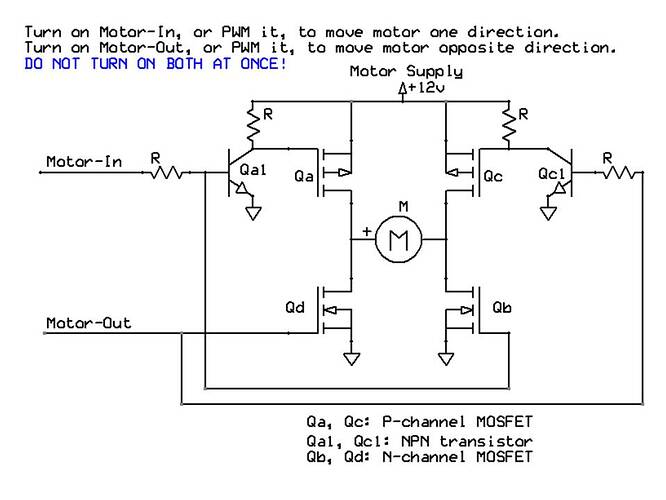

You need the linear actuator to go both directions? Then you need an H-bridge.
With 12A, you want really low Rds parts, as power dissipated in the MOSFET = I^2R
So 12
1210mOhm (milliohm) = 1.4W for example.
The cooler the MOSFET is, the smaller the heatsink needed.
Some examples:
N-channel
<4.5mOhm at Vgs = 4.5V, 12
12*.0045 = 648W
P-channel
7 mOhm, 1212.007 = 1.008W
Another option with relays and single N-channel MOSFET for speed control.
