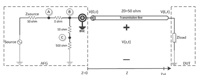

A ED article (a sales attempt to justify expensive function signal generator) states in summary:
...the actual output waveform’s amplitude changes based on different load impedance under low-frequency conditions. But as frequency increases, the system circuit models become more complex. In this case, it may be necessary to regard the cable as a transmission line and consider reflection and complex load (not only resistance, but also inductance or/and capacitance). Under certain mismatching conditions, the amplitude and shape of a waveform produced by an AFG can end up being significantly different from the ideal source output. These conditions are usually caused by mismatched load impedance or the use of mismatched long cables. The impact of bad reference waveforms can be significant, including measurement errors that lead to inaccurate conclusions and, under extreme conditions, damage to the DUT.

I agree that the I2C bus is not a transmission line as Hams radio operators or even AC electrical engineers would recognize; still if I drop back to those old Laws, it makes more sense to me: match everything up, honor the bus specification, minimize power loss and the signal transmission will be better.
