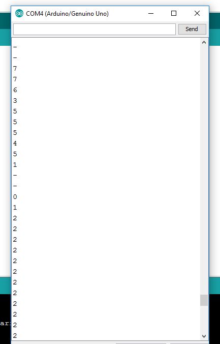

I put the println statement where you suggested, and the attached screenshot (capture1) shows the results in the serial monitor. What I would expect is that when the Android phone is tilted up at the top (y-axis) I get a positive number 0-9 in the serial monitor, down at the top I get a negative number 0-9, down on the left (x-axis) I get a positive number 0-9, and down on the right I get a negative number 0-9. All those numbers correspond with the degree of tilt on the android phone What does happen is that I get a positive number 0-9 in the serial monitor when the phone is tilted down on the left (x-axis) or up at the top towards me (y-axis). If the phone is tilted down at the top or down on the right, negative numbers, all I get is the - symbol. I do get an 'a' or 'b' from the android when those buttons are pressed.

  Serial.println(receivedChars[0]);

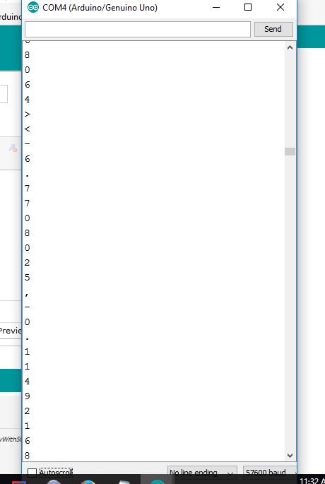

If I put the println statement like this:
void recvWithStartEndMarkers() {
  static boolean recvInProgress = false;
  static byte ndx = 0;
  char startMarker = '<';
  char endMarker = '>';
  char rc;
  while (mySerial.available() > 0 && newData == false) {
    rc = mySerial.read();
    Serial.println(rc);
I get the results I would expect. It looks like the attached screenshot (capture). I get numbers I expect like: <-6.7708025, -0.11492168>
by the time the data gets through the motorControl function, the serial.println results are all 0 like the screen capture and sketch in my reply 17. Not what I expect. Any ideas?
Let me ask this. Your device is sending -6.7708025, -0.11492168, which doesn't equal 'a' or 'b', so you call motorControl() to deal with the string.
You get the token up to the comma, -6.7708025, and call atoi() (ASCII to int). Why? Does that value LOOK like an int?
You are going to get -6 as the return value, which you pass to analogWrite(). Why? What do you really think it is going to do with a negative value?
